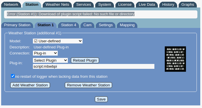

Are you using a Meteobridge deice with a "scripts" folder?
The files mbwbpi.plugin (the awk script) and mbwbpi (config file) both have to go into the scripts folder. When setting up the user defined plugin weather station after selecting script:mbwbp from the Select Plugin dropdown list, be sure to click the "Reload Plugin" button before clicking Save.
MB outputs a superflous error, but it still works on my MB:
Error (Station #1): Download of plugin script failed: No such file or directory
MB screen should look like this:
mb ss.png (59.92 KiB) Viewed 6020 times
