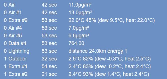

In my experience the lightning sensor shows only up in the live data when a lightning is recorded - and then for some time after that.
For how long exactly I haven't fully traced.
Not sure if a reboot of the GW1000 or what makes the info disappear.

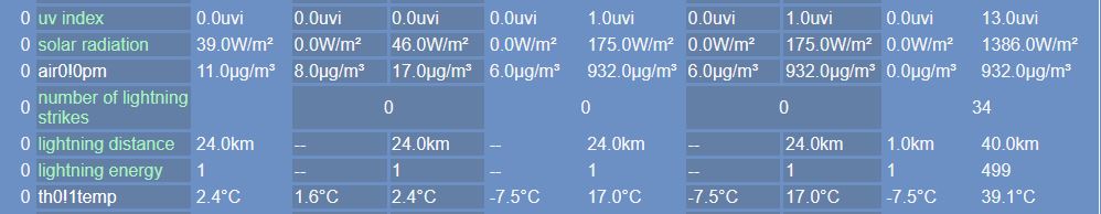

The proper recording of lightning in MB has in my memory always been an issue, and I think it's still not solved.
I had complained several times and provided documentation - at no (visible) avail.
Lightning events were very strangely and - in my opinion - not correctly/consistently reported in the history (min/max)
But as I live in an area where lightnings are the exception, the issue has gone to the background.
I will try to create a fake lightning event again and see what it gives.
How to create a fake event ? I put the flash of my camera in front of the sensor and make it flash. 8)
I managed to create a fake event - and the sensor appears - the recording is still somewhat strange in the min/max (the labeling has improved though) - how can a recorded event have a count of 0 ??? :? .
And there's no difference in my MB Pro or in my RPi4 installation.

Boris sticks to a weird translation from Chinese (made by Chinese people) in the GW1000 API which says "energy" which is very misleading.
(Not only) I kept on telling him to get a proper name for that, it's the time stamp of the last strike
the three API fields are:
lightning_distance distance to last lightning strike
lightning_last_det_time Epoch timestamp of last lightning strike
lightning_strike_count cumulative lightning strike count
right now, even though there is a lightning event for today, I do not see it in my database.
There's no sensor to be selected.
I checked in the database (with a database tool from my backups).
The tables are there, but none contains a timestamp of today ....
Last entry is from last year September, for each of the three in all -hour, -day, -month, -year, -all tables.
As there are no minute data but only hourly data for this sensor, maybe it is still hidden in the RAM database and will show up in the persistent database after two days ...
