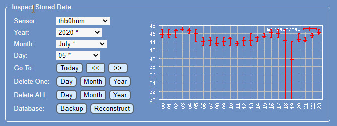

My MB Pro Red has been running for around a month now but have noticed that every day, there are around 10-15 occasions grouped within a 1-2 hour period where thb0hum records 30% relative humidity which then has an impact on the computed dew point. Since rebooting MB yesterday, I have also seen individual readings from thb9temp and thb9hum randomly reported with values of -14.8C and 58% respectively.
Whilst the thb9 readings aren't so much of an issue for now, the data from thb0hum requires a significant amount of manual processing to remove the erroneous values.
Any thoughts would be appreciated.

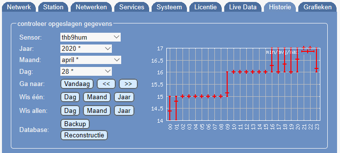

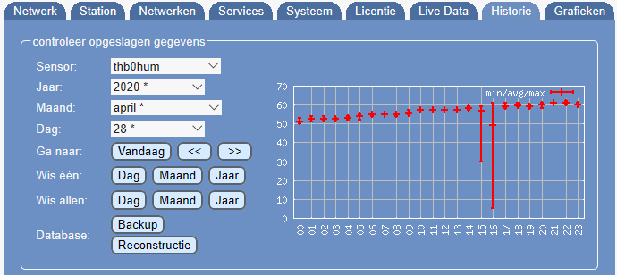

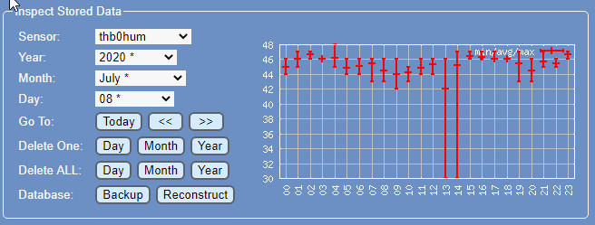

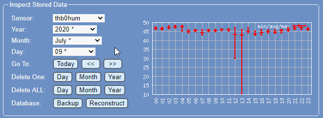

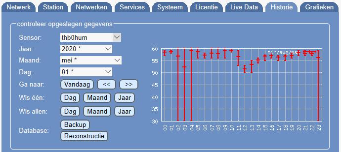

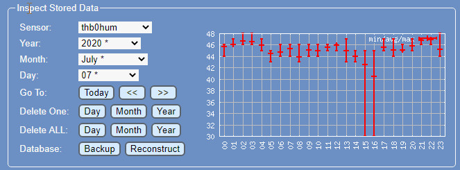

My new Pro Red board seems to suffer from same problem. Every day at random times thb0hum drops to "30", sometimes even lower, see attached screenshots.

The other board parameters like thb0temp, pressure don't show outliers. thb9hum doesn't show such drops, but it's absolute value cannot be humidity. It's more like a temperature range of values. It does not show any drop-puts like in thb0hum.

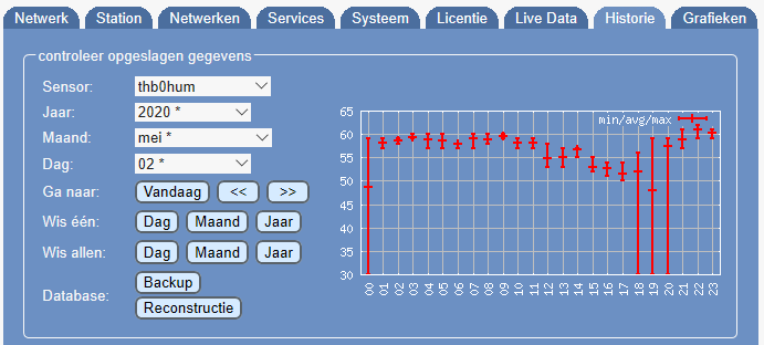

The problem with thb0hum continues to happen every day.
MB Pro th0hum problem-4.PNG (22.59 KiB) Viewed 3102 times
Is there any sight on a solution by software?
Or should the hardware to be changed?

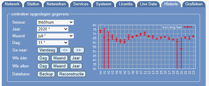

It appears that I also have the same problem and it appears to have a cycle to it if you look over several days.
