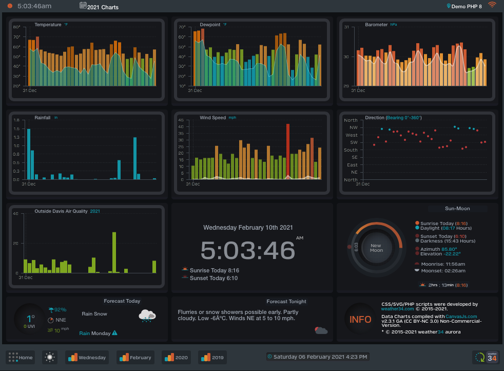

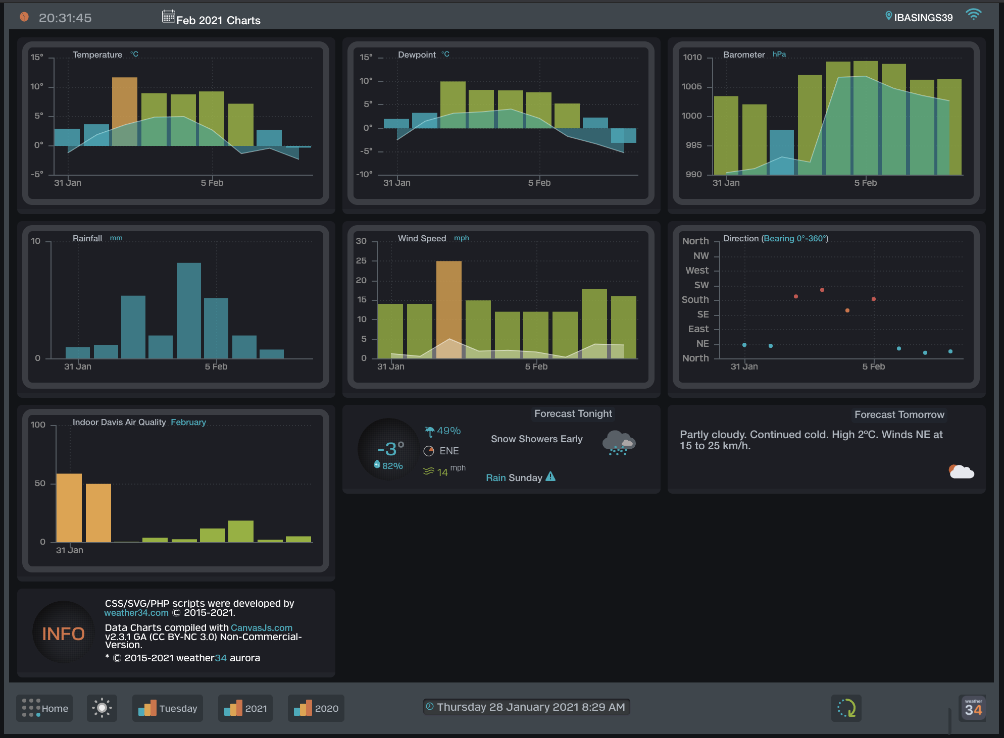

Brian, one issue with adding the AirQuality to the Monthly and Yearly charts a layout challenge for those of us who do not have UV & Solar sensors:
- Posts: 1824
Good morning
added a fallback for that scenario just a small piece of code "what if else do this" line .should resemble below if no uv sensor and Davis airlink ==yes

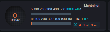

I just uploaded your latest Lightning update. It is now showing a recent strike "Just Now", but have not had any since in a few days.
- prestwickwx
- Posts: 510
Got it. All fixed.

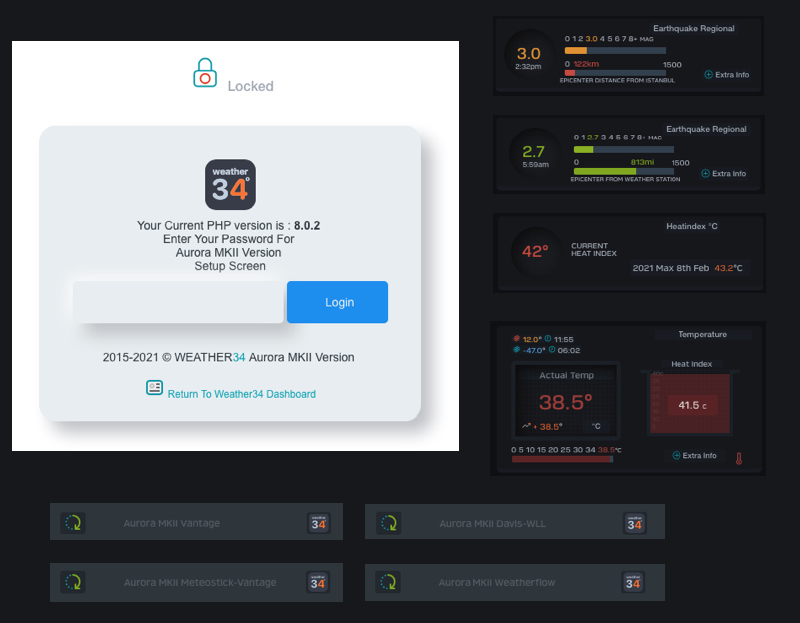

They were
1. missing heat index in the API
2. minor appearance change to login screen for setup
3. reworked the earthquake regional module . which only displays regional earthquakes based on your Lat Lon upto 1500km radius (THEORITICALLY)
red is less 150km/mi , yellow less than 300km/mi , green 500km/mi or greater in distance away
4. Cleaned up code for heat index display so easy to overlook scenarios when not in season here thanks Jodie(Australia)..
5. minor css changes nothing significant.
6. Removed Ecowitt compatibility tired of the inept emails so there you go , simply use something more suited .see FAQ for the total crap I got sent..
7. Added simple hardware ID to footer bar some Hardware ID examples shown in screen shot
8. FAQ was added to info site and hopefully you will see my side of the coin why I drastically reduced features to keep it maintained in a manageable way instead of just walking away due to fatigue and never ending upkeep.I have always said if it doesn't suit your requirements there are multiple choices of alternative templates to fulfill your requirements.
*Verified full compatibility with PHP 8.02 release
