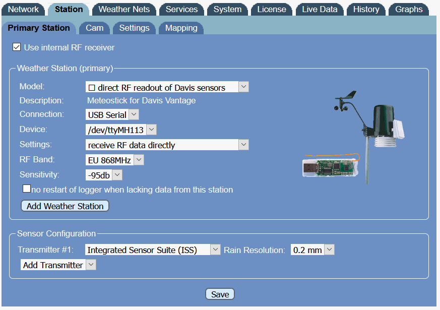

Presuming this to be under the Station > Primary Station tabs (screenshot below), (1) I see no option to change bandwidth from small to normal and (2) I’m not clear on how to select the transmitter ID that the console is using for retransmits.
Under Settings select "Receive RF data via console(Re-transmit)"
This has to be set in the console and on a different Tx ID to that of the ISS, Can be changed via the Console or in WeatherLinkPC. Do you have a console manual? Do you have a logger connected via a PC?
Since your current ISS is transmitting on #1 and if your console was re-transmitting on #2 then you would remove the Transmitter #1 from the Sensor configuration box and add a Transmitter #2 as Integrated Sensor Suite (ISS)

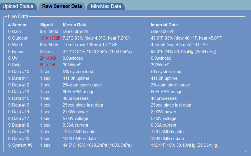

I attach some recent raw sensor data, which is particularly bad. Note no UV signal for 2 hours and no solar for 6 hours. These are the ones that are most likely to be missed - and which also report least frequently (every minute, but every 5 minutes when dark). Most of the signals are in the -30 to -50 db range, so are being re-transmitted from the console, although solar at -91db would seem to be direct from the weather station. Incidentally, the indoor temperature, 0 Indoor (assuming it is from the console, with 9 System #9 being from MB), is 16.5 C higher than what the console is displaying.

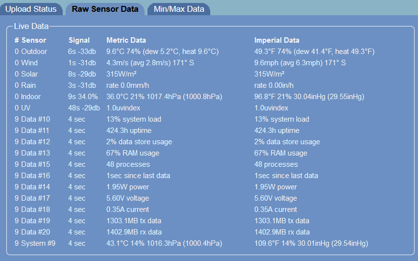

After only 12 hours of data on the new setting (having changed sensitivity from -95 db to -85 db), I am confident that the issue is resolved. I am now seeing data from all sensors every few seconds/tens of seconds, the weak signals are absent and the strong ones have become even stronger (now typically -25 db to -35 db, see image). Graph lines on Weather Underground are unbroken.

Re: Meteobridge Pro (red) & Davis Vantage Pro2 Plus reception/re-transmission issues
The 34% at the Indoor sensor tells you how many received RF packets were good (here about just 1/3 passed the CRC check). As signal is really strong (presumably MB PRO very close to the retransmitting console) I would recommend to go to -70db which will reduce bad packets and by that improve stability of data.

Hi, thanks for the additional suggestion and it’s useful to know that the percentage value on the indoor sensor is how many RF packets were good/passed the CRC check. I left it for a couple of days before making any adjustment to see how representative that 34% figure was. It turns out it was particularly low, typically I was seeing 60-80%.
I then changed the sensitivity to -70 db as you suggested and over the past few days I have been seeing typically 75-95% and even the occasional 100%. Data continue to come in every few seconds at typically -30 to -35 db. I’m very happy with those numbers - thanks again!
