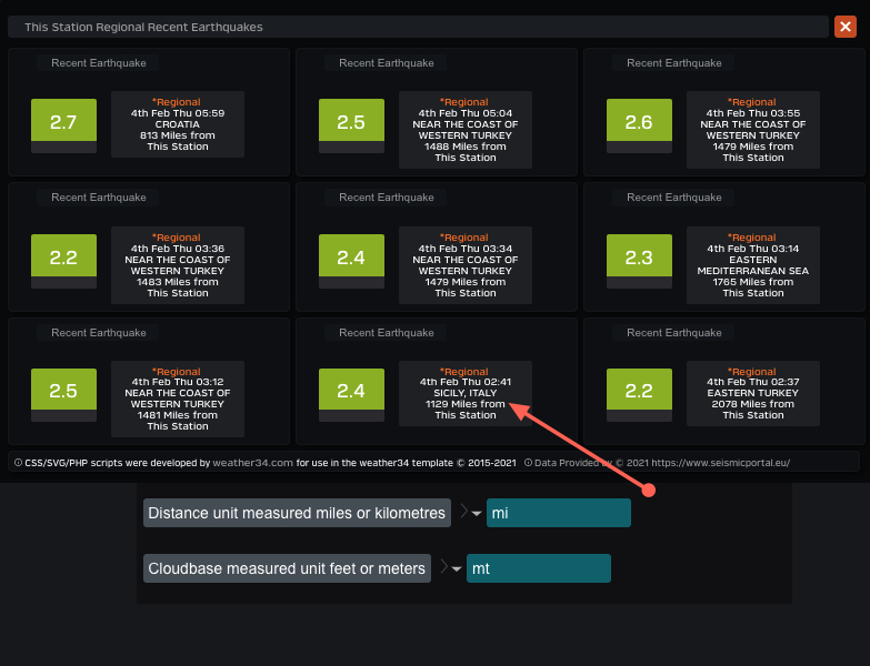

I did the fix Brian,
Two Things
1 it says at the bottom of the module epicentre distance Istanbul..
2 when I open the extra info the distance is in miles whereby in the module it is in KM, but it has the same number so in module it says 393 km but in extra info it says 393 miles..
3 I’ve got an appointment for my Jab on Thursday!!
PS I’ve had a little hack of the file so it looks right .. but I’m sure it isn’t as you intended
I changed the word Istanbul to Station and KM to miles.
Gary Bridge MIET, MIPS.

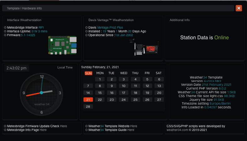

Ive just updated the update file to show correct km or mi according to setup choice. also note the small info diag screen its nothing significant it simply
helps me get an idea of some basics I often need when an issue is raised from those who perhaps are not familiar with template. serves nothing other than telling me what could be the issue outside of the template.

weatherist34 wrote: Sun Feb 21, 2021 4:40 pm thank you a transition of mine got left in there . surprised you use it any earthquake concern in your neck of the woods ? ...:-)
* Fix earthquake km or miles selection Ref Graham (5:23pm).
* Adds simple diag info (5:23pm).
* Important API updated requires meteobridge reboot (17th Feb).
Debby (Other Half) is into Geology, which she has been studying with U3A ( university of the 3rd age)
Who is Graham at 5.23?
I thought it was my turn to be famous....
Had your Jab yet?

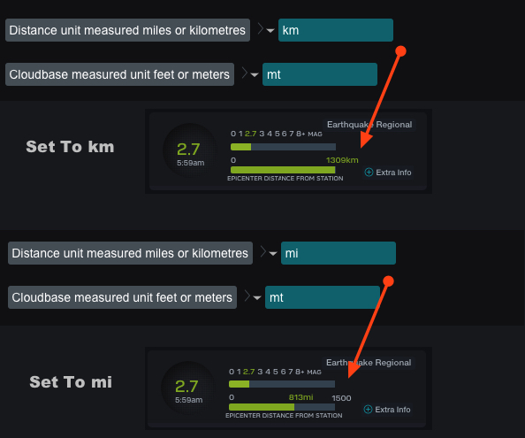

So I've done the update, the module changes from Mi to KM as per settings... The extra info is staying in KM ? Is that how you intended it?
controlled via the setup screen option for distance unit .

Sorry...
Further update to my confusion..
It appears that the module responds to distance measurement as per Admin setup whereas the "extra info" follows the UK/Metric toggle.
Is that correct?
Regs
Gary
try running the update from this morning , it should be only relative to whatever is set in the setup screen.
note the purple air VOC minor fix also.
* Fix Purple Air Voc if zero anomaly Ref Lars (11:57am).
* Compiles update file to match GITHUB master (11:45am).
* Fix earthquake km or miles selection Ref Gary (11:45am).
* Adds simple diag info (11:45am).
I must go now I think the update should resolve the confusion..have a good day..

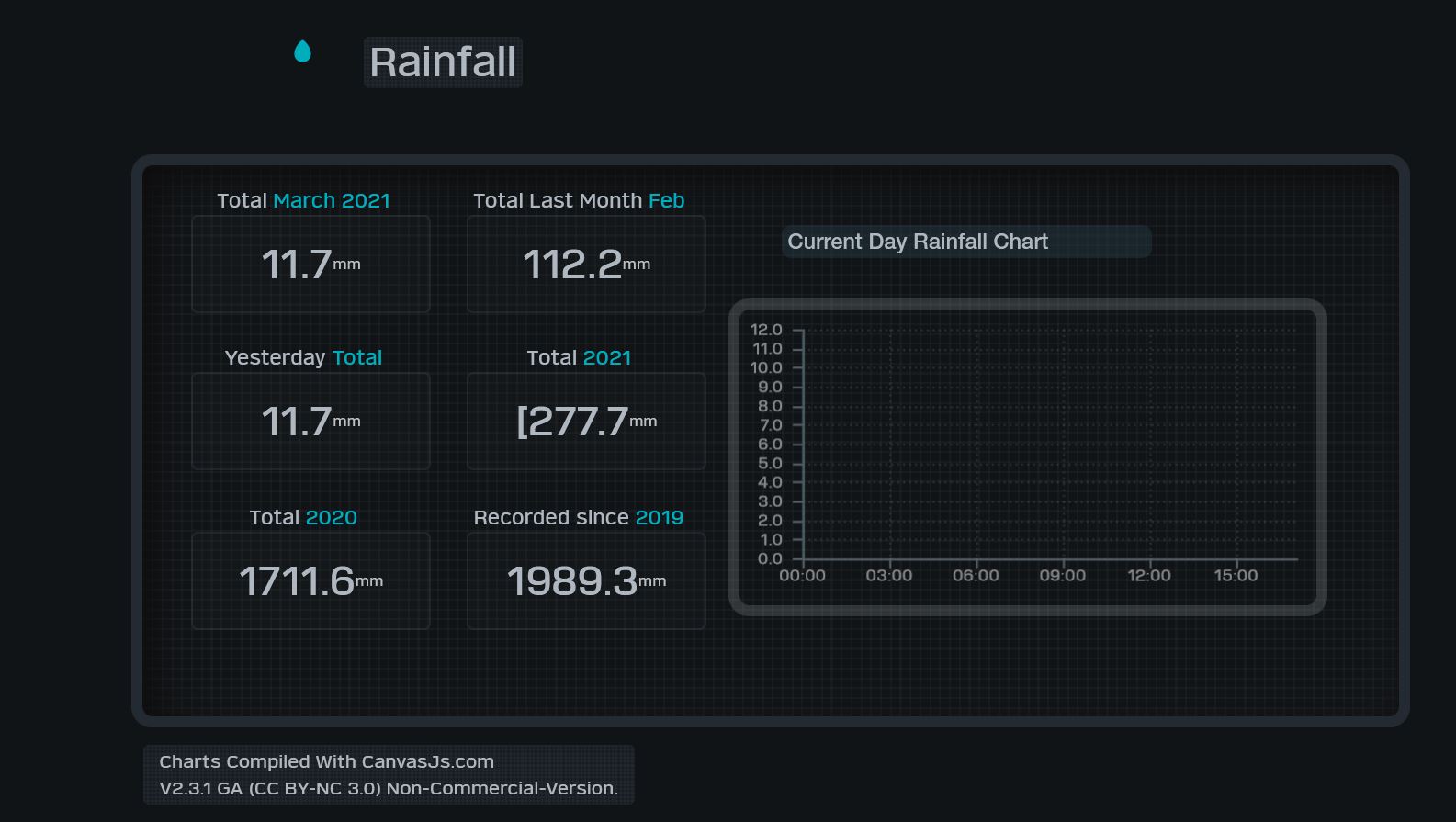

I noticed a strange character (square bracket) occurring in my rainfall summaries (extra info).
I hadn't been there earlier ...
Any idea where it comes from and how to get rid of it ?
