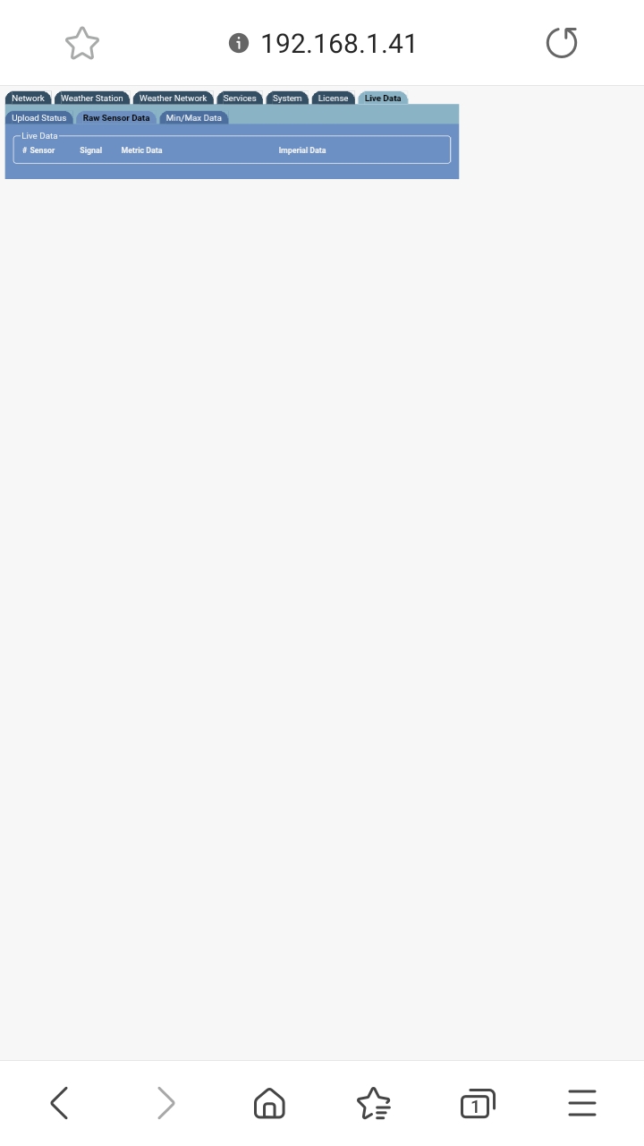

Just updated today
- Screenshot_20210301-153308_Samsung Internet.jpg (52.04 KiB) Viewed 7847 times

GW1000 is running firmware 1.6.5. After the 1.6.5 update; Meteobridge was working fine. It was only today after updating Meteobridge the problem appeared.
I have both devices set with static ip addresses and both are correct.

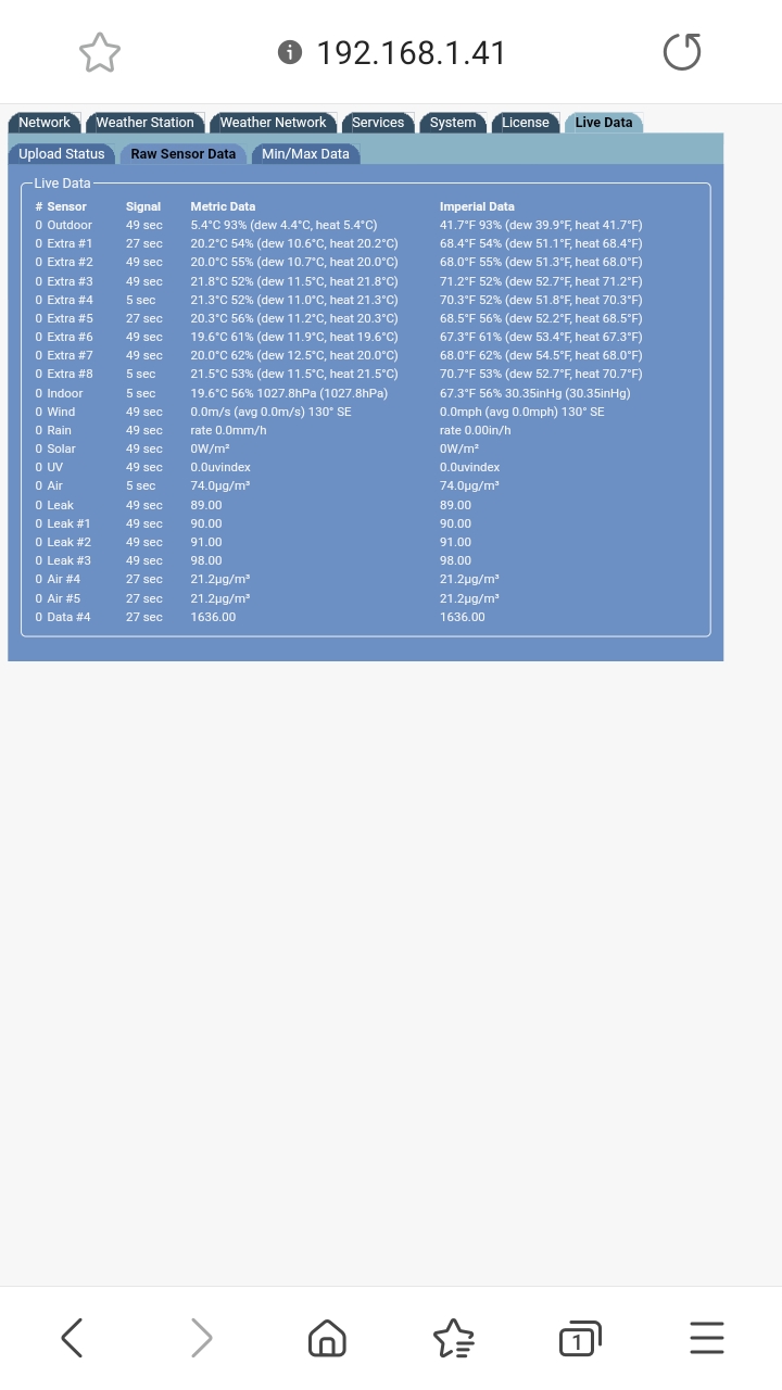

Thank you galfert so much.
Running Meteobridge 5.0 ; it's working again.
- Screenshot_20210301-194555_Samsung Internet.jpg (201.47 KiB) Viewed 7814 times

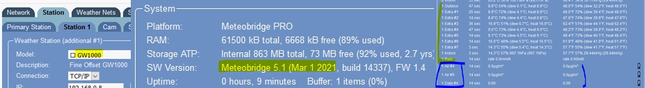

Not working for megalfert wrote: Thu Mar 04, 2021 2:44 am Further testing by other individuals shows that there is no problem with GW1000 firmware 1.6.6 and MB 5.1 March 1st release.
- Screenshot_20210301-153308_Samsung Internet.jpg (52.04 KiB) Viewed 7700 times

hello
for my part no problem with my GW1000 and the last fw 5.1 release on the other hand I find myself with an unknown "device" (Air)
- Capture_mb-horz.jpg (99.65 KiB) Viewed 7696 times
