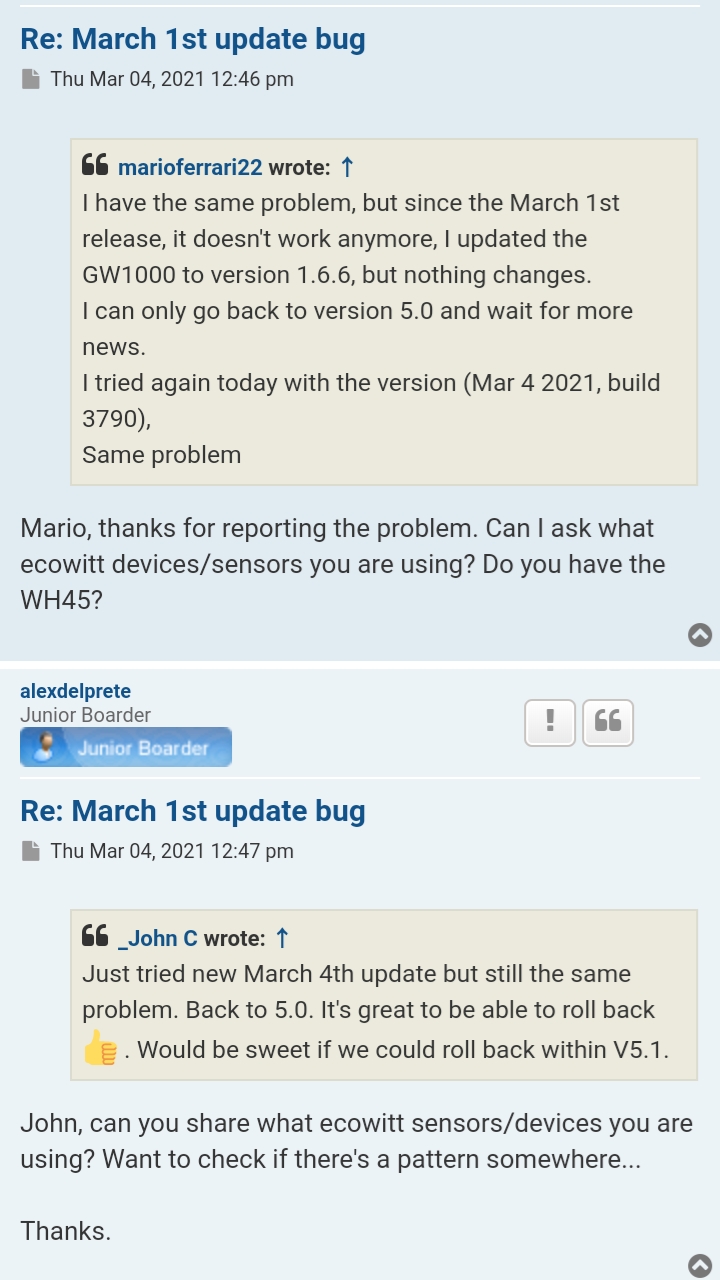

Just tried new March 4th update but still the same problem. Back to 5.0. It's great to be able to roll back
. Would be sweet if we could roll back within V5.1.

I've emailed Boris. There is significant changes to firmware 1.6.6 that may cause some people to experience connectivity issues and not others. It likely is because everyone has different sensor combinations. Seems that the changes in firmware 1.6.6 are ignored in MB 5.0. That may make no sense but programs change. To me it just signifies that MB 5.0 parsed data differently.

Here are my sensors:
Ecowitt GW1000
WH41 PM2.5
WH51
WH2320CE/wh4000
