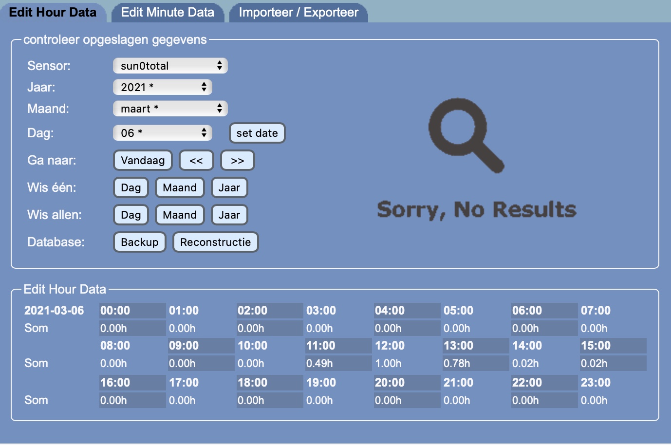

So Meteobridge handles the sun hours as sun0total, sun0rate, sun0signal and sun0lowbat.
Sun0total is an incremental counter that stats even day at zero, same as the rain totals.
Schermafbeelding 2021-03-10 om 21.56.28.jpg (234.7 KiB) Viewed 3846 times
For some reason the graph for this is not generated, but you see the hourly sums, in decimal hour format.

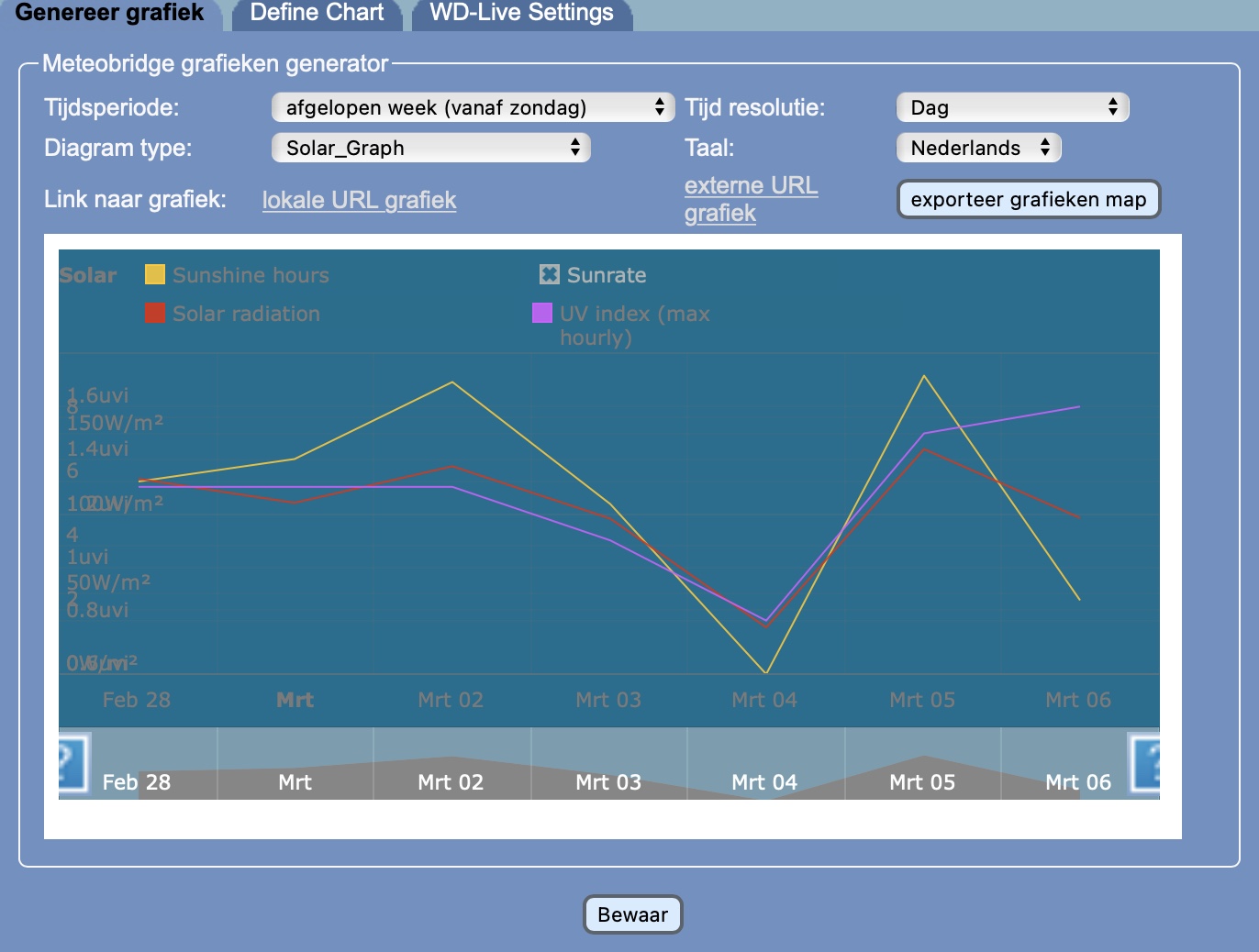

You can display the results in a graph like this:
