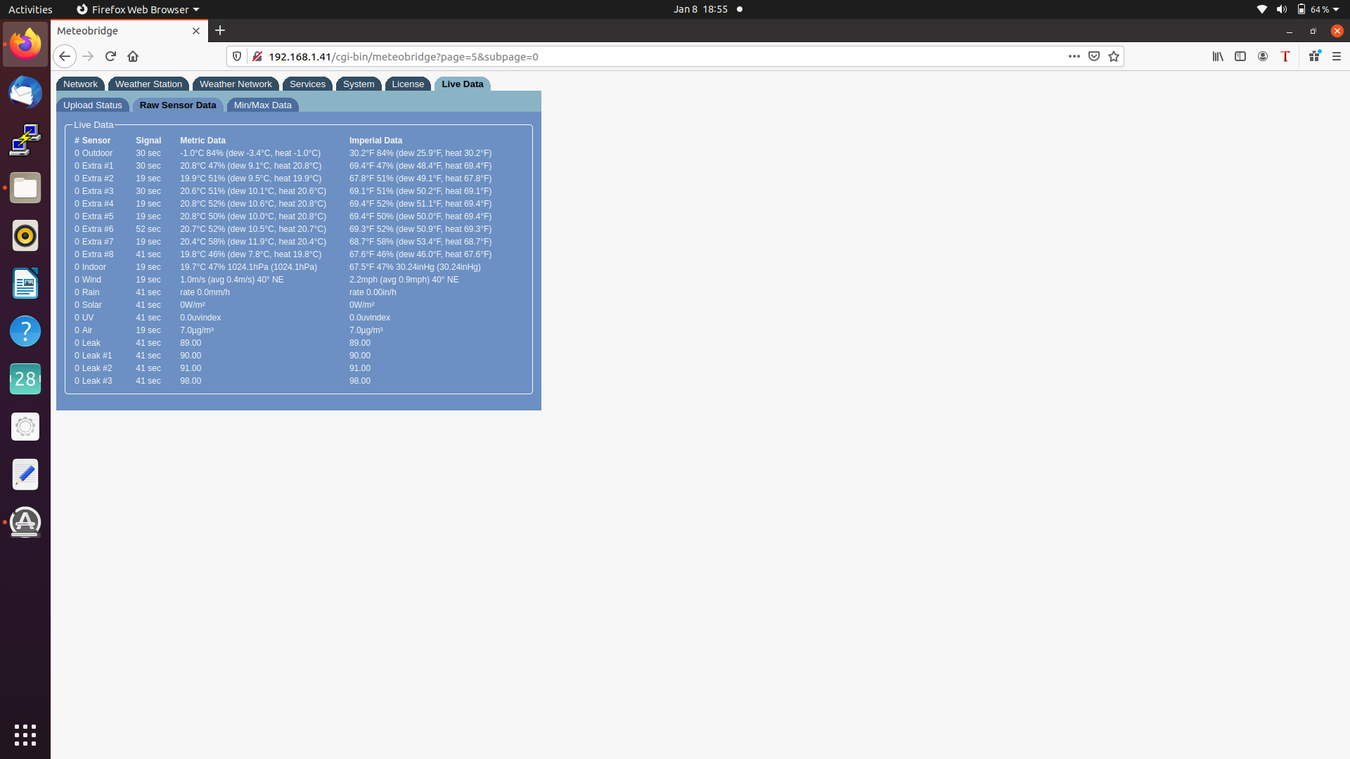

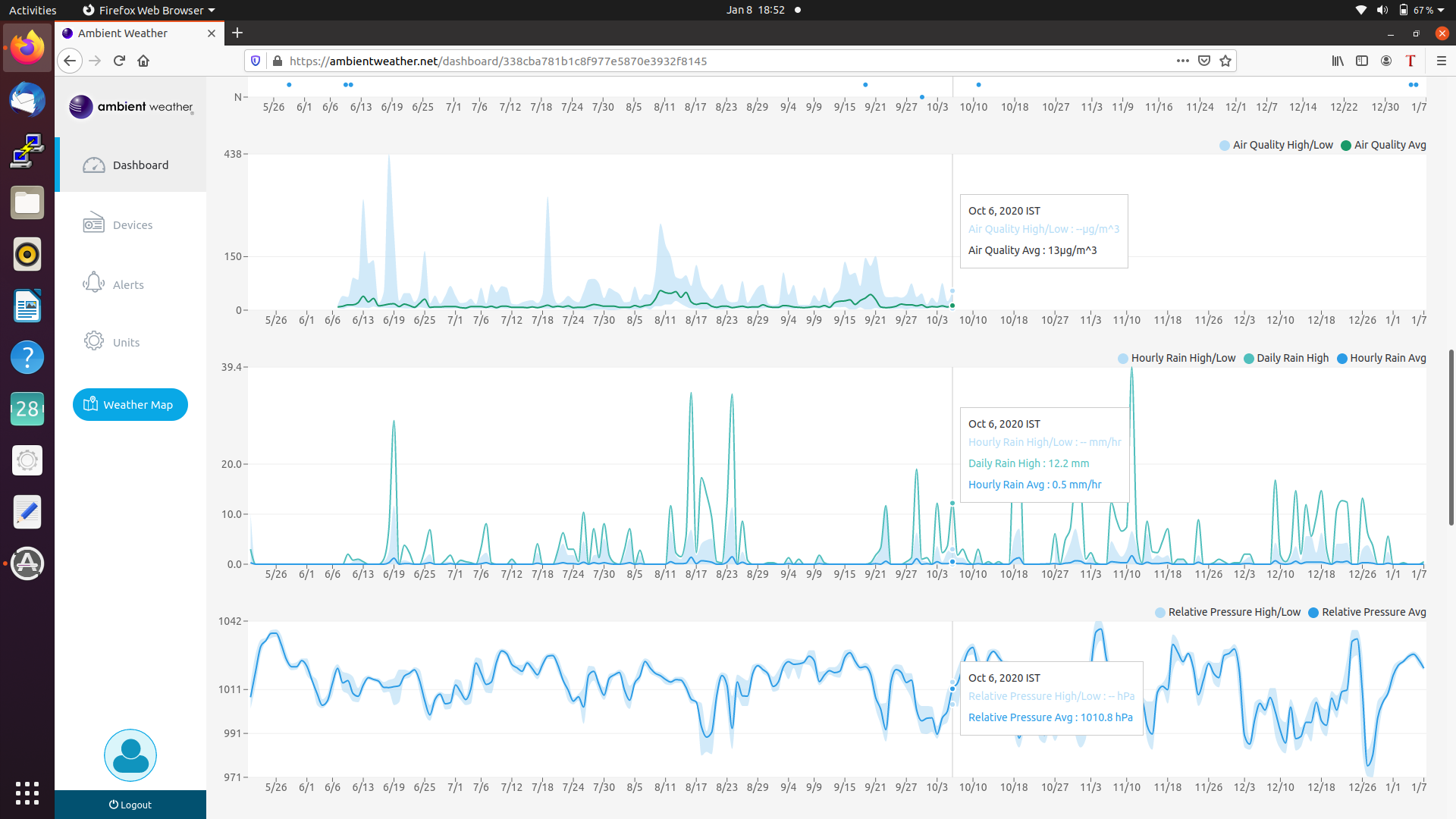

I'm using an Ecowitt GW1000 with an outdoor WH41 PM2.5 air quality sensor. Ive noticed that my air quality data has not been received by Ambient since the 6th of October. The sensor data does show up in the Meteobridge raw data page. Anyone else have this problem?
Im Running :
Meteobridge 5.1 (Jan 8 2021, build 3708), FW 1.3. TL-WR902ACV3
All the best,
John
Raw Sensor Data.png (230.39 KiB) Viewed 3597 times
Missing Air Quality Data.png (341.46 KiB) Viewed 3597 times

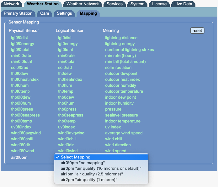

When I see it right, there is no mapping of the three available physical air quality sensors (air0!0pm, air0!4pm, air0!5pm) to the corresponding logical sensors. Please do on "station - mapping" tab.
Bildschirmfoto 2021-03-10 um 22.16.57.png (151.72 KiB) Viewed 3392 times

Mapping air0!0pm to air quality (10 microns or default) fixed the upload to Ambientweather.net. But it seems strange that the description of 10 microns is the default. I thought most air quality sensors are 2.5 microns as a default.
Seems like on the Meteobridge air0pm is considered 10 microns and air1pm is considered 2.5 microns. Maybe I'm wrong...but I think I would have reversed these two designations....am I missing something?
Meteobridge RPI | GW1000

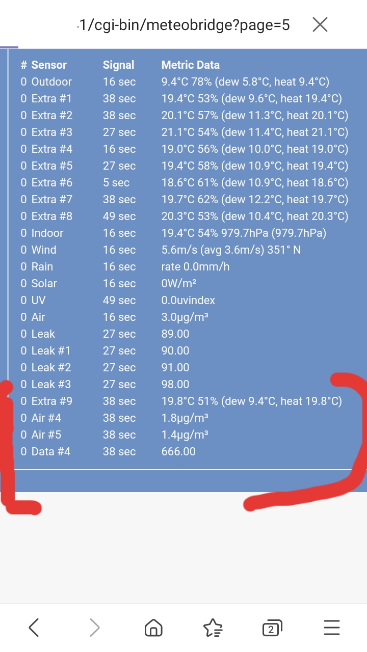

I've also got a WH45 sensor (PM2.5/ PM10/ co2). Does Ambient allow data from this sensor to be uploaded ?
If so, would it be possible to do so with Meteobridge?
_John C
Posts: 43
Joined: Thu Jun 11, 2020 5:31 pm
Re: Missing Air Quality Data
Post by _John C »
Extra #9 is WH45 Temp/Hum
Air #4 is WH45 PM10
Air #5 is WH45 PM2.5
Data #4 is WH45 co2
