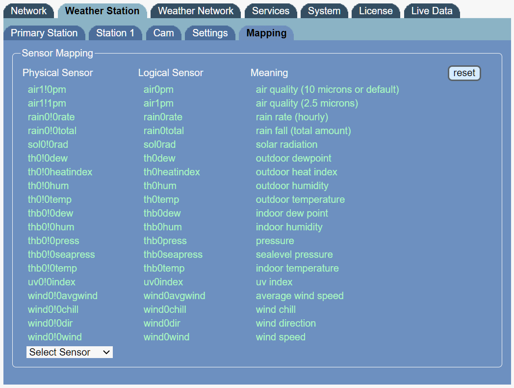

I am using a WeatherFlow Tempest station and Meteobridge is mapping some of the sensors as "indoor" data. Tempest doesn't have any indoor temp/humidity/pressure sensors.
I've tried to correct this using the Mapping screen of Meteobridge by selecting and setting the affected sensors (thb0!0dew, thb0!0hum and thb0!0temp) one at a time, to "No Mapping", but Meteobridge isn't saving the setting... I see no "Save" button in this screen! Is there another way to force Meteobridge not to use these and/or correctly map the sensors?

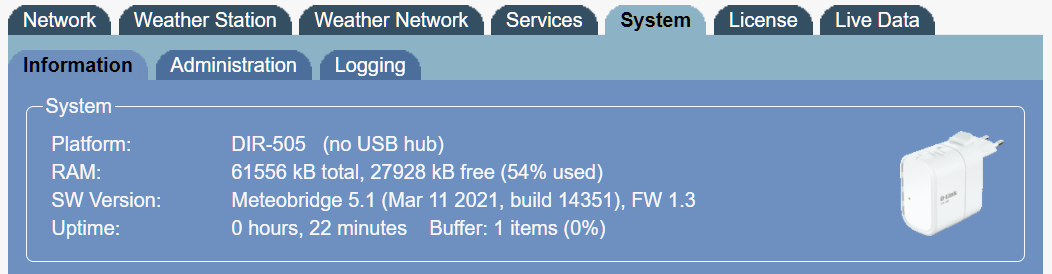

I just tested sensor mapping on my DIR-505 with most recent SW and it is a bit slow but it works fine.

By the way, I just checked the latest version, and the issue with mapping a sensor as "No Mapping" is still there. It seems to take effect until you leave the tab. Once you leave the tab (i.e. after the setting the sensor to "No Mapping" let it accept the mapping and then go to any other tab) and return back to the Mapping tab the original mapping for that sensor returns (i.e. the "No Mapping" does not stick).

For this specific station the data is also reported as indoor data (as the station does not have a console providing indoor data) to avoid compatibility issues with further processing. Just ignore.
Re: Sensor Mapping is not being saved. **solved**
Unmapping basic sensors needed for reporting to weather stations is not supported. You can remap those but not unmap. There is no point in umapping those.
