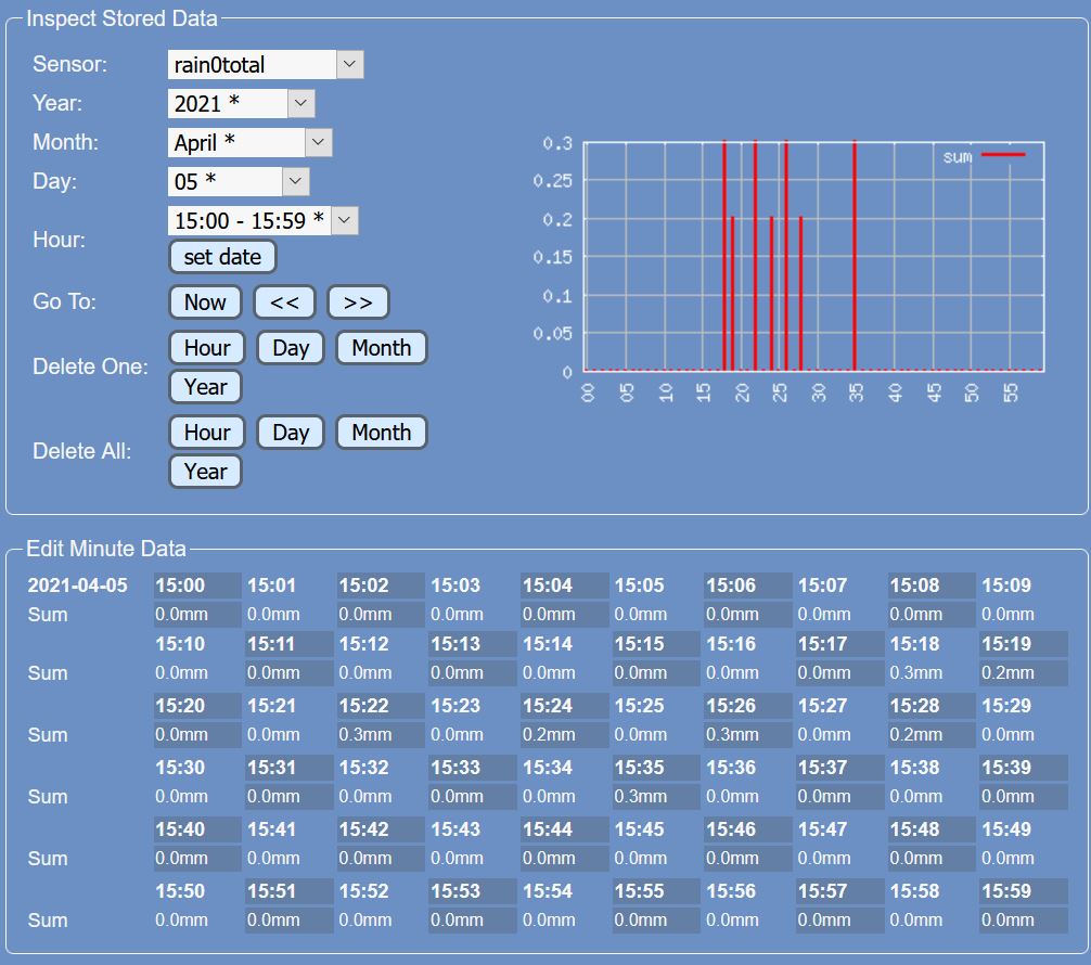

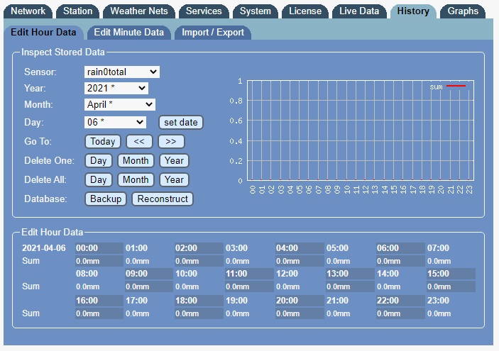

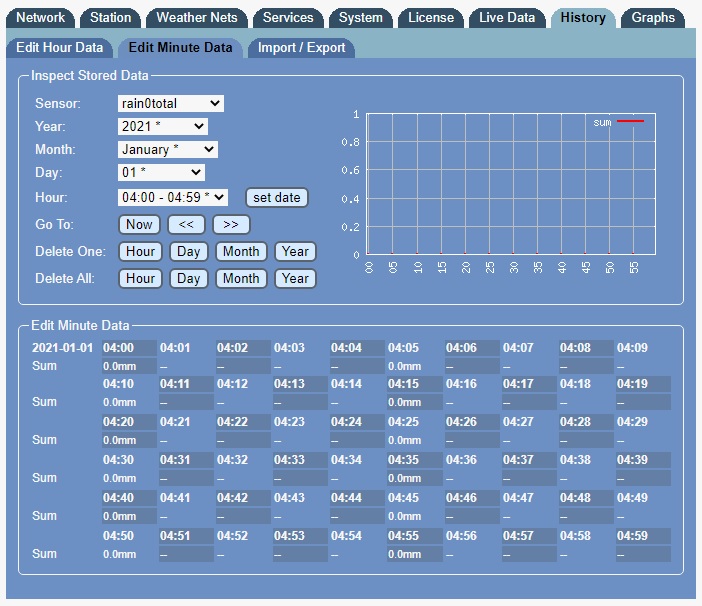

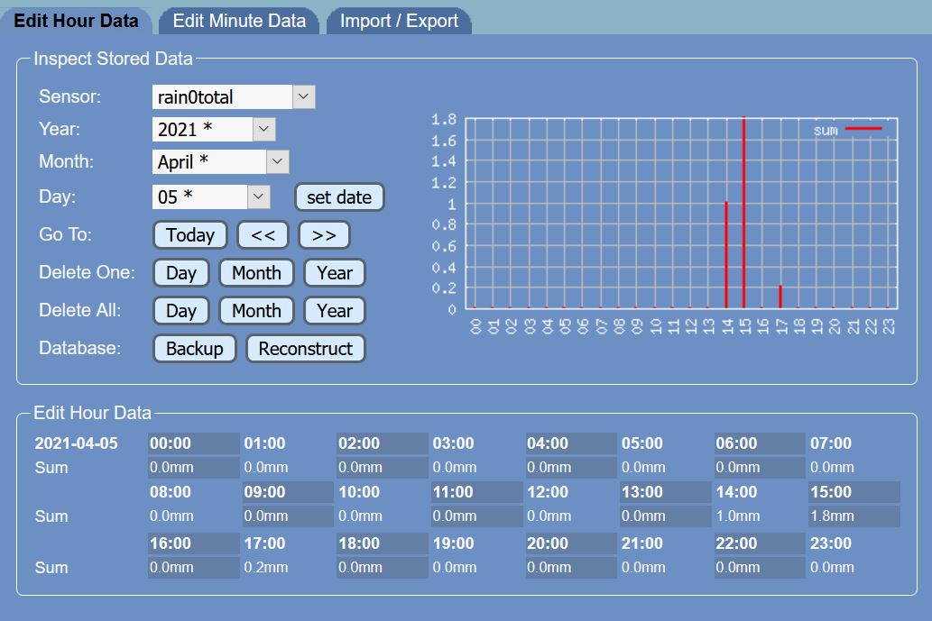

No updating, so I copy-paste the relevant parts of the database I am cconcerned with:
Following chunk of data corresponds to the rain problem
'2021-01-01 04:30:00','10.3','10.3','10.2','75.0','6.0','20.0','31.5','335.0','0.000','0.000','1016.500','0.0','5.5'
'2021-01-01 04:35:00','10.4','10.4','10.3','76.0','6.3','19.6','35.4','336.0','0.000','0.200','1016.700','0.0','5.7'
'2021-01-01 04:40:00','9.9','10.4','9.2','80.2','6.6','25.9','40.7','326.0','15.600','1.200','1016.900','0.0','4.1'
'2021-01-01 04:45:00','8.8','9.2','8.5','82.6','5.9','19.6','38.9','307.0','6.100','1.400','1016.800','0.0','4.0'
'2021-01-01 04:50:00','8.4','8.5','8.4','84.0','5.8','16.3','27.8','315.0','4.300','1.400','1016.600','0.0','4.3'
This is a copy-paste of the relevant data in the MB/RPi4B-8GB
As seen, no proper update of the rain totals have been done. MB said that in the log... but why?

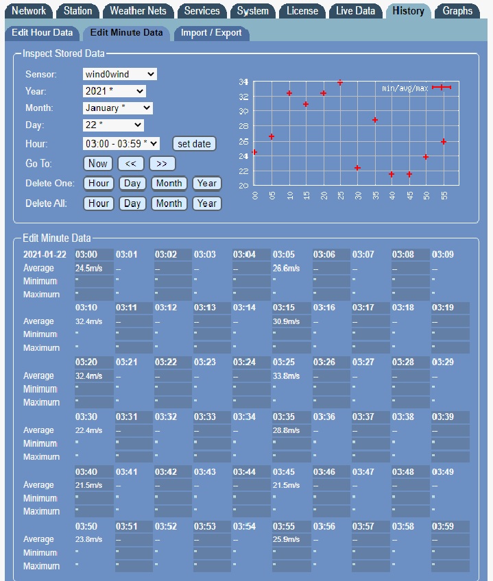

Following chunk of data corresponds to the wind problem
'2021-01-22 03:00:00','14.0','14.1','14.0','87.0','11.8','26.7','54.7','255.0','0.000','0.000','1013.200','0.0','9.4'
'2021-01-22 03:05:00','13.9','14.0','13.9','85.8','11.6','28.3','59.4','268.0','0.000','0.000','1013.200','0.0','8.9'
'2021-01-22 03:10:00','13.9','14.0','13.9','82.6','10.9','31.1','72.4','273.0','0.000','0.000','1013.100','0.0','8.2'
'2021-01-22 03:15:00','14.1','14.1','14.0','80.4','10.8','32.2','69.1','287.0','0.000','0.000','1013.200','0.0','8.1'
'2021-01-22 03:20:00','14.1','14.1','14.1','76.4','10.0','32.4','72.4','281.0','0.000','0.000','1013.200','0.0','7.8'
'2021-01-22 03:25:00','14.1','14.2','14.1','75.0','9.7','30.3','75.6','279.0','0.000','0.000','1013.400','0.0','8.2'
'2021-01-22 03:30:00','14.1','14.1','14.1','75.0','9.7','27.3','50.0','263.0','0.000','0.000','1013.300','0.0','8.7'
'2021-01-22 03:35:00','14.1','14.1','14.0','76.2','9.9','25.3','64.4','282.0','0.000','0.000','1013.400','0.0','9.2'
'2021-01-22 03:40:00','14.0','14.1','14.0','77.0','10.0','24.6','48.2','260.0','0.000','0.000','1013.400','0.0','9.3'
'2021-01-22 03:45:00','14.0','14.0','13.9','77.8','10.1','24.1','48.2','251.0','0.000','0.000','1013.400','0.0','9.3'
'2021-01-22 03:50:00','13.9','14.0','13.9','78.6','10.2','21.8','53.3','278.0','0.000','0.000','1013.400','0.0','9.8'
'2021-01-22 03:55:00','13.9','13.9','13.8','78.6','10.2','21.2','58.0','265.0','0.000','0.000','1013.200','0.0','9.9'
'2021-01-22 04:00:00','13.8','13.9','13.8','76.8','9.8','23.5','46.8','277.0','0.000','0.000','1013.400','0.0','9.3'
This is a copy-paste of the relevant data in the Meteobridge
Again no update as per the log. The wind problem arose when I detected those 33.8 m/s at 03:25 of day 2021-01-22,
that don't correspond to the average wind speed of 30.3 km/h nor to the 75.6 km/h gust Meteotemplate registered.
Might be a unit conversion problem? I doubt it as there is no fixed factor along the database either...
It doesn't look an easy problem but I cross fingers for a solution that it could be related to some details I might over looked

The rain would not update and the wind is persistent in spite of an apparently successful update of data.

regarding rain
I don't know how MB processes the input - anyhow except for your 1st line (which would provide "0.00" - as rain is the 4th value from the right) something should be there.
did you try the direct format for your rain totals ?
e.g.
1609471800 rain0total 0.0
1609472100 raintotal 0.2
1609472400 rain0total 1.0
1609472700 rain0total 0.2
and see what it gives.
Maybe the import function does an INSERT, and as you have already inserted the record before in your earlier attempts, it will not update it, just omit it. But the direct import could (speculation, hope) only go and update the single table entry.
If it doesn't work, you would need to try with an interval you haven't tried to insert yet.
(or use a SQL script with UPDATE - will be a bit more complex)
- 1609471800 is the EPOCH date for 01-Jan-2021 04:30:00 (seconds since 1.1.1970 UTC)
- as MT summarizes the rainfall, I guess you should use the difference to the interval before
- direct import needs a line feed at the end of the line

The wind problem was solved quickly with the direct file import, which I find great as it does not need a lot of formatting and gets the values numeric, which is a great advantage. Sample file follows...
1609461900 wind0wind 13,4
1609462200 wind0wind 13,4
1609462500 wind0wind 15,4
1609462800 wind0wind 12,1
1609463100 wind0wind 13
1609463400 wind0wind 11,3
or
1609461000 wind0avgwind 7,4
1609461300 wind0avgwind 8,2
1609461600 wind0avgwind 6,4
1609461900 wind0avgwind 7
1609462200 wind0avgwind 6,6
1609462500 wind0avgwind 8,1
Yes! No problem, MB understands 13 or 7 as 13,0 or 7,0... No hassle!

if this generates the result which you want, all is fine - HOWEVER in the history at least the data is displayed as rain0total per time slot (e.g. 1 hour or 1 min) see example from a rain event below from yesterday (so the display is not additive - but maybe the respective import [if there had been one] needs to be the accumulated value reached at that time slot).
You can verify with some report/chart/template.

- MB-history-rain0total_minute-20210405.JPG (135.06 KiB) Viewed 3139 times
- MB-history-rain0total_hourly-20210405.JPG (107.8 KiB) Viewed 3139 times

Yes rain database update was trickier due to various reasons. I wanted to check today with a testrain.txt direct file, wihich contained in two different ocassions the following data, to check for proper input data into sensor time slot...
1617706800 rain0total 1.0 (to check for total rain of 06/04/2021 at 11:00:00 slot)
1617706800 rain0total 229.3 (to check for an adition of 1 liter to previous accumulated yearly rain, that was 228.3)
Did a backup first, and then, none of the direct file imports succeeded as per the log reading...
backup (07.04.2021 10:51:22): backup media size is 3.7G (3.7G free).
backup (07.04.2021 10:51:54): backup completed: dbase-202104071051 (72.1M)
import (07.04.2021 11:03:34): import of file "testrain.txt" (0 kb) started: type 0, mode 0
import (07.04.2021 11:03:34): completed 1 lines, performing 0 database updates.
import (07.04.2021 11:04:29): import of file "testrain.txt" (0 kb) started: type 0, mode 0
import (07.04.2021 11:04:29): completed 1 lines, performing 0 database updates.
But what it did was restoring all rain data to deletion. (Lucky me I foresee that and did a backup)
