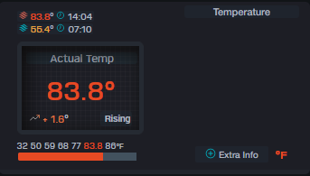

Just noticed that I have an issue with the temperature module. I have not seen it before today - but this is the first day that temperatures have been this high.
The Firefox console shows this error "The resource at “https://myrtleweather.com/console/fonts ... font.woff2” preloaded with link preload was not used within a few seconds. Make sure all attributes of the preload tag are set correctly."
Take care,
sorry its a short reply but I missed the heat index threshold was set >28c should have been >30c (86F)

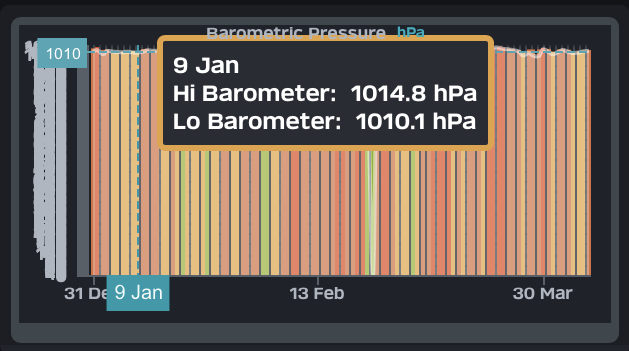

In the small Almanc view, which can be accessed via the "Extra Info" button, the chart legend does not always fit for small values.
Posts: 259
... in the chart view for the year 2021, 2020*** and act month, the legend for the barometric pressure is not displayed.
Edit: Cause found, the morning execution from today of weather34-chart-end-of-day.php wrote „8 Apr,,,,,,,,,,,,,,,0.0“ for me. I deleted the line in 2021.csv and april.csv, as well as started the weather34-chart-end-of-day.php manually. Now everything fits again and the legend at the barometer chart is back. However, under the link *** is still to see and seems to have happened there?

looking at the chart the owner has an erroneous pressure value hence the big spike requires editing the appropriate csv file.
to help you i would look closer to home for these type of anomalies “the template only reads data” the data comes from meteobridge and is saved to file . if it was a template issue then the occurrence would be daily and obviously would have been fixed months or years ago. in recent months it was found to run end of day at 2am was reliable has running at midnight had a risk of meteobridge not being able to compute all previous days data in a such a short time frame of just seconds after midnight. i and a small amount of others had this issue so shifting to 2am proved to be a solution to ensure all previous days data hi,lo,avg was saved to file as expected.

I mean the left legend at Barometric Pressure. This representation comes, if in the csv file, entries with „8 Apr,,,,,,,,,,,,,,,0.0“ are.
Also here https://weather.k1ttc.com/AuroraMKII/co ... s-2020.php
ha but thats because there is an erroneous value in the file generated , not sure how to avoid that , if i was to add a what if scenario to remove that view you would not be aware there is a discrepancy in file so kind of can be to your advantage. template can not stop that scenario being generated either by meteobridge or server . in barometer data i can add minimum value of 25 if below that do nothing in view display reason is 25 because of non metric if all were using hpa,mb,mmhg then i could set it to a higher value. but doing that only hides it from view doesnt remove the source of the problem.

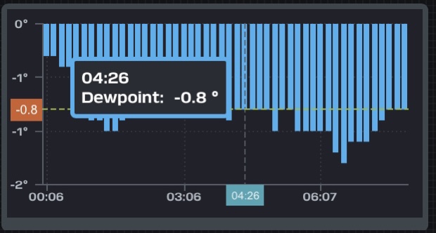

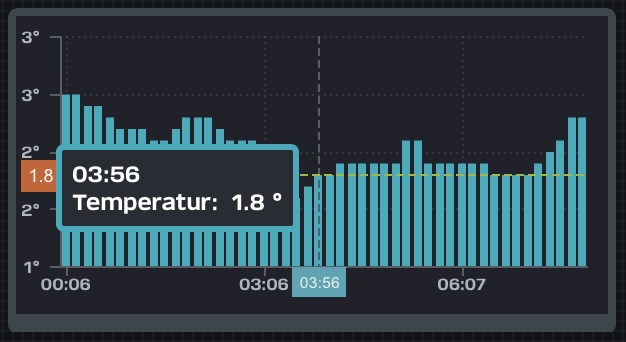

This morning addressed some things you raised but limited time so I did adjust two things using the url chart data you provided with the barometer errors .That said it only hides the error generated so be aware if the data from pressure generates an error frequently it will be missed .
*** Using 2am for end of day run is the safer practice .***
Download Update 11th April 2021
* Ref Toto Barometer chart intervals when error in data (08:13).
* Ref Toto Day Chart Temperature/Dewpoint intervals (08:13).
