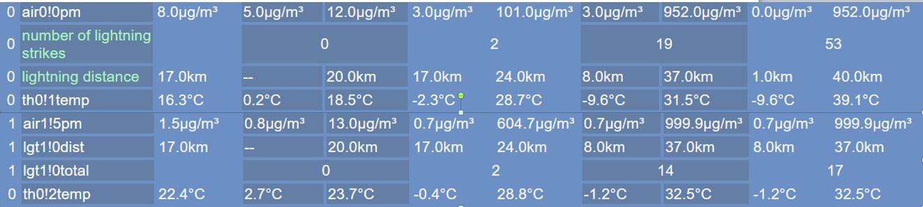

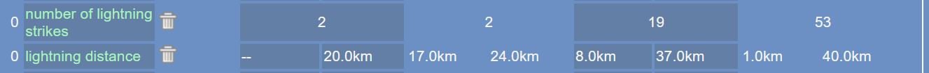

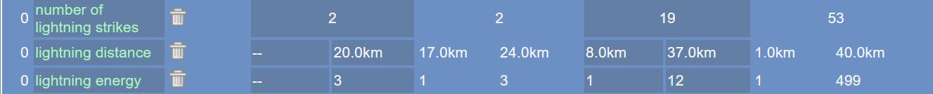

Hi Boris,
this is the umpteenth (and hopefully final) request from many forum users for straightening out the naming of the three sensor values provided by a Ecowitt WH57 lightning sensor.
(By the way - that's not meant as criticism, but as a proposal for a constructive solution of the issue. :D )
There are many posts in the forum which have this imo wrong naming and assignment for reason.
I am aware of the fact that the API documentation has been in a bad shape with English/Chinese mix-ups etc. - but it should be meanwhile clear what each sensor value means - and I find this should now also be updated in Meteobridge.
(by the way: other programs like weewx and CumulusMX have come to a proper and reasonable naming).

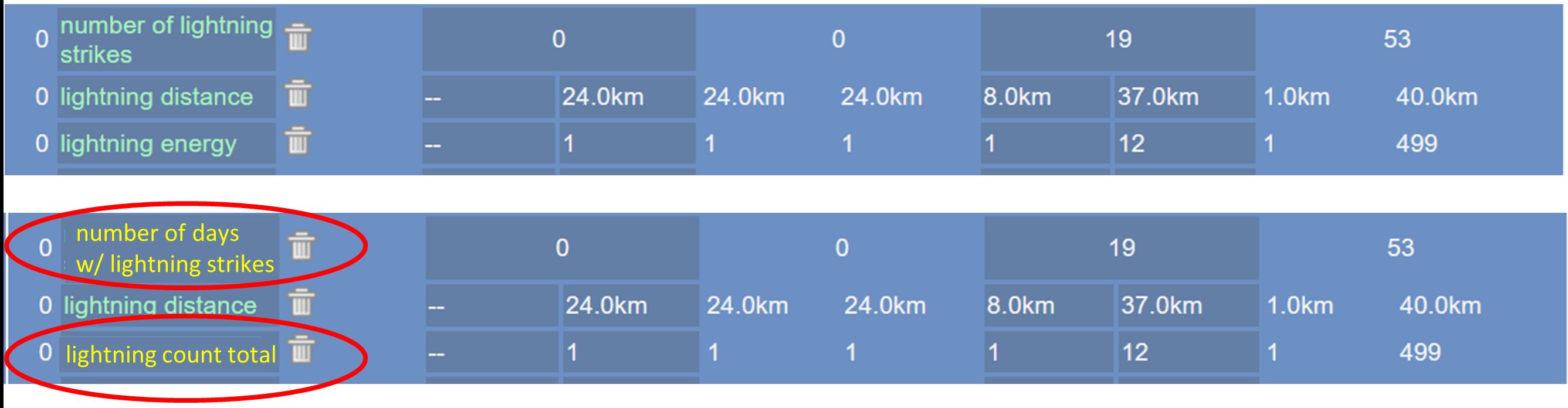

I suggest the renaming in the min/max history as shown in the picture attached. If "number of days w/ lightning strikes" is too long,
it could also be "days with lightning strikes"
Also your naming is wrong regarding the content
- what you call "number of lightning strikes" is the "number of lightning strikes per day" i.e. on that day when the strikes occurred
so calling it total (lgt0total), is misleading; total,yes, but only total at that day
having the sensor name lgt0total is in my opinion wrong - it would be your lgt0energy but imo better named lgt0day.
- what you call "lightning energy" is the number of strikes per period (day, month, year, all time); that would deserve the sensor name lgt0total
simply speaking in a nutshell: you have to switch lgt0energy and lgt0total ! - And use fitting text - proposal in the picture

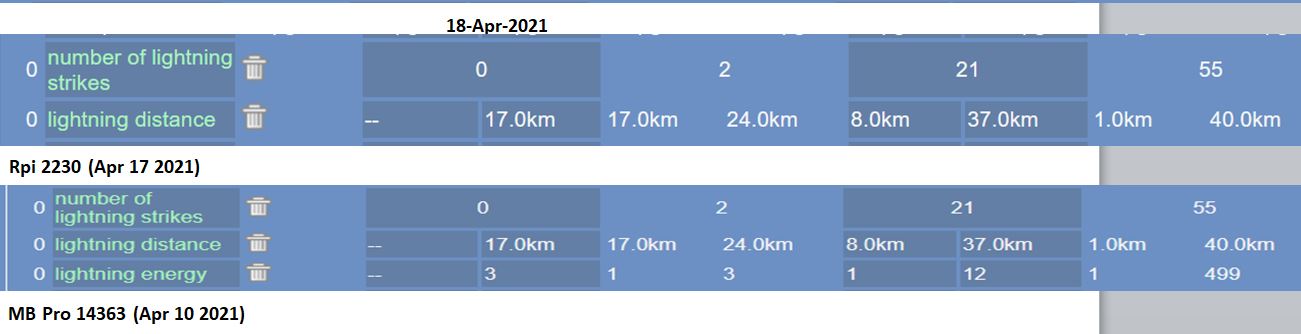

Mmmh - the test of RPi2230 is not very encouraging (yet) ...
see below from the min/max table
1. # of lightning today was 3, shown is zero (today), the counts haven't been updated (see earlier picture)
2. distance is correct (has always been correct)
3. total number of strikes is completely missing now (your sensor lgt0!0total, lgt0total is the # of days with strikes per period)
the numbers allow only one interpretation, as there cannot be 53 strikes in total but on 499 days =>
it has to be 499 strikes in total on 53 days (before the event)
(unless my strike number has been messed up in the past in the database, but I didn't touch it)
expectation (and imo correct display) would be
number of lightning strikes (today): 3, month 4 (1+3), year 22 (19 + 3), all time 502 (499 + 3)
distance is correct anyway
number of days with lightning (today): 1, month 3 (2 + 1), year 20 (19 + 1), all time 54 (53 + 1)
But it doesn't show that.
What confuses me in addition is lightning distance and the total count (earlier picture), where in the year it say 8 km / 1 (one above the other) and 37 km / 12 - should this be the number of strikes of the extreme values ? out of the yearly strikes 1 was at 8 km distance and 12 were at 37 km distance ? That would explain the strange numbers. (the same with the all time numbers, one event at 1 km distance and 499 events at 40 km distance - but how does this relate to the number 53 ??) - but I'm not sure if and how the numbers of the two lines are supposed to be interrelated.
EDIT: 17-Apr-2021-18:52
After some time, at least one hour, the min/max table now shows the strikes of today, even though one too few:

the not updated MB Pro shows:
if we go by the picture above,
- the first line should show "1", not "2" - it can only show 1 or 0, no other number (as it is days with strikes, 1 or 0)
- the distance is clear and ok
- the "energy", the occurrence per day, strikes per day is correct - there have been 3 strikes today
about the month and year column I am doubtful - it looks to me as if the "energy" line shows the min/max distance and its total occurrence in the period considered (where the all time value doesn't seem to make sense - looks as if two different things have been packed into one line)
If we want to show these min/max occurrences of the distance, we should add one more line - so altogether 4 lines:
(1) number of days with strikes in the respective period (today, month, year, all time)
(2) distance - min/max
(3) number of strikes of the min/max distance in the respective period
(4) total number of strikes in the respective period (today, month, year, all time)
in the above case this should be:
now        today      month        year          all
(1) --          1             2             20            54
(2) --      17/20km   17/24km    8/37km    1/40km
(3) --        2/1            2/3          1/12        1/499
(4) --        1/3            1/5          1/??         1/502 (or more, depending on the real all time total; 499 may only be the 40km #)
in my opinion (3) would be sort of luxury information (but would make it different from other software !), whereas (1), (2) and (4) should be there in any case, because they give important information.
(the ?? would need to be looked up and probably summed up from the database)
of course, depending on the time of looking at the table, let's say within the last 30 minutes, the now column would also have a value
I think that apart from a to-be-corrected counting of the days with strikes, (3) and (4) have been packed into one line and that's pretty much of a mess.
Maybe I don't understand the full logic myself - I'm open to a better explanation - and its proper depiction :)
