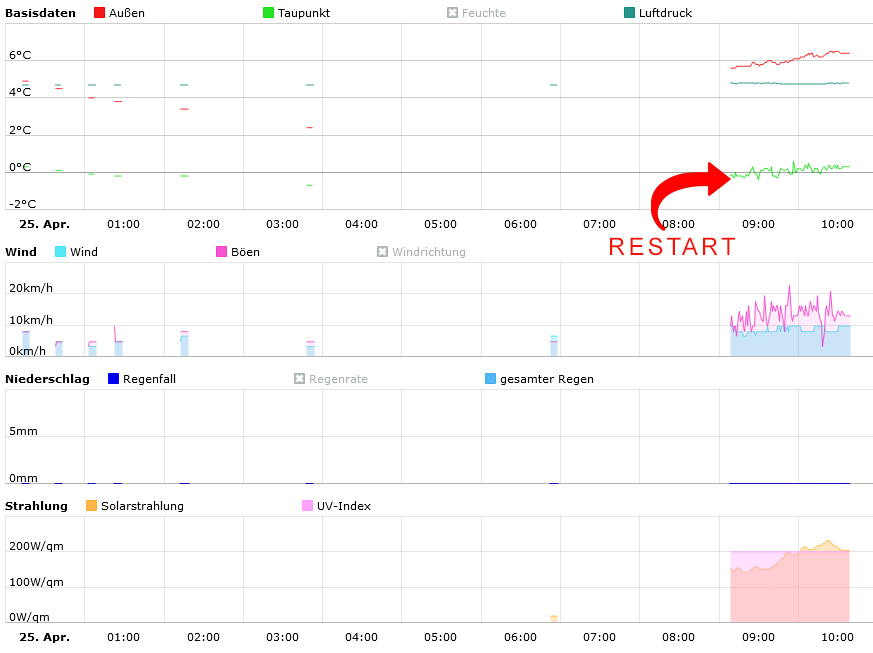

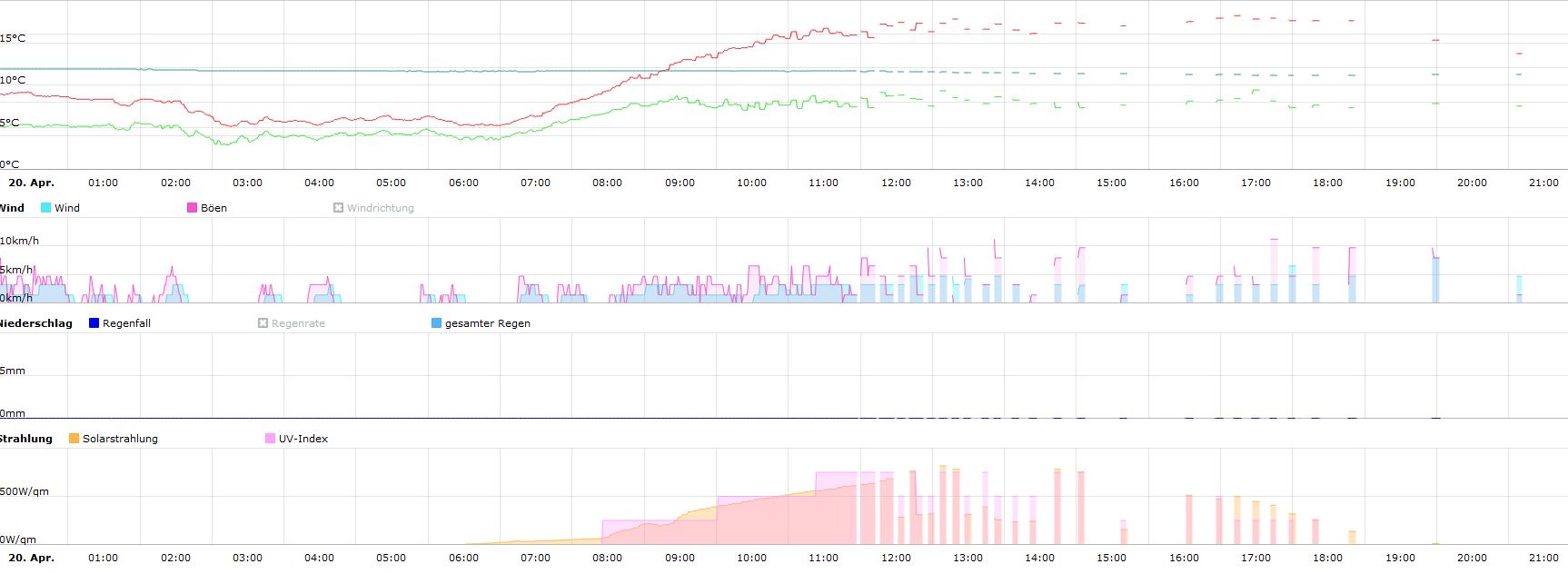

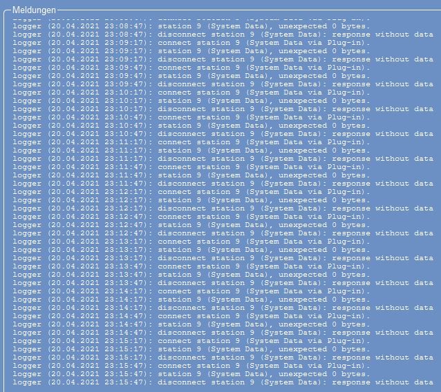

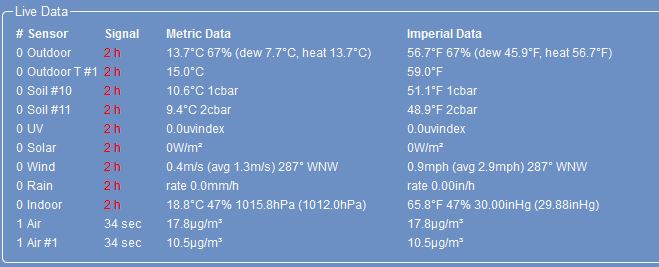

Since a few days Meteobridge has an recurring issue with receiving data from Davis Vantage Pro 2 connected via USB. This problem is resolved after MB has been restarted (pls. see screenshots). Issue appears every day. Wswin is meanwhile running well. Nothing has changed in configuration disregarding regularly FW upgrades. Could you pls. investigate?

Please retry with newest version.

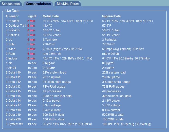

Sorry, same issue appears ~24h since last restart (including update to latest version from 21.04.2021),
suddenly Meteobridge stops receiving data from Vantage 2 Pro (as you can see in the screenshots):
Re: Response without data
Can you please provide me a remote login? FAQ explains how. Please send URL and PW to "info(at)meteobridge.com".

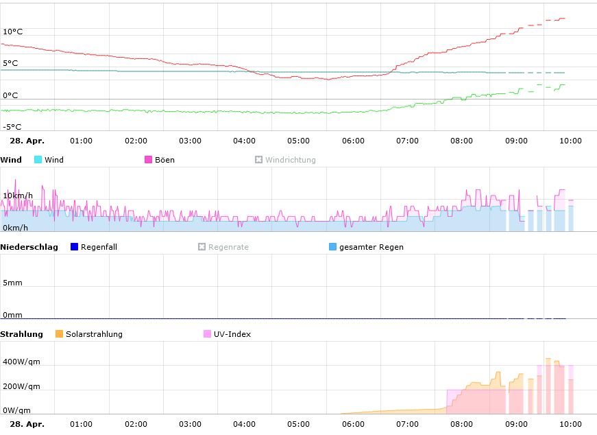

The same issue appears still once per 24h:

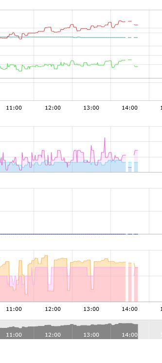

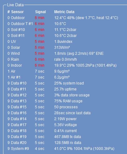

Happy too early, issue is still existing :?
Could you pls. go ahead investigating this issue?

I already asked for a remote login. Your RF receptions does degrade for some reason.
