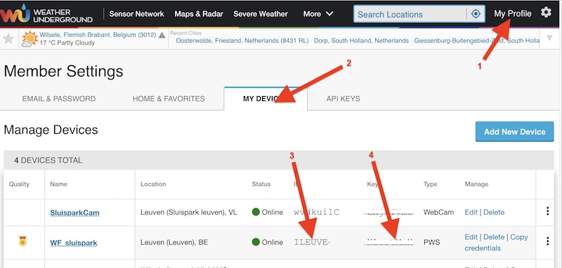

For uploading to WU you need the exact station ID (all capitals) and the "upload Key", they are different for each station.
Only in rare cases (older stations?) you can use a WU-password
Go to the https://www.wunderground.com/login website
Use your email and password to login
Click at the top right at "My profile"
Click tab devices.
If you already defined your weather-station, you use the ID and Key to setup your Meteobridge.
It can take up to a few hours before the data is arriving at your stations page.
But the page should be available to visit without data on it.
https://www.wunderground.com/dashboard/pws/_ID_
That _ID_ always starts with an I if you are outside the USA.
If your station is accepted, you will get a FREE API-key.
succes,

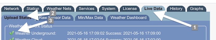

Logon to WU and copy / paste the station name and key to your Meteobridge.
Press save and check after a few minutes at the tabs "Live Data" => "Upload Status"
If there is a green mark, the data is uploaded to WU and it should appear at your stations page at WU
If there is no green checkmark: you could try to use your customer password, not the station key for uploading.
I still have a station which only accepts the password for uploads. It depends on what WU is willing to accept for a specific kind of upload.
