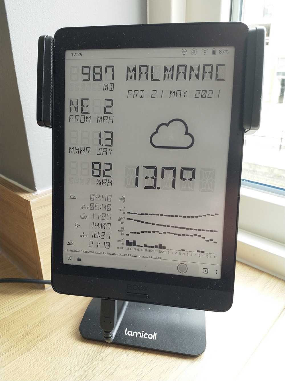

Templates on a website, and those tips, already suggested are a great idea.
I have my own web server and coded a screen-specific HTML web page for an ePaper/eInk tablet that simulates an LCD look (image below). The Meteobridge Pro makes HTTP requests from Services with data parameters in the URL. The web server saves these to a database, a server-side scripts page reads these and renders them as a standard web page using fancy LCD fonts (https://www.keshikan.net/fonts-e.html); the web page auto-reloads every 15 minutes (meta refresh tag in the HTML). The pages also includes some particulate air quality data and tide/astronomical event times included from elsewhere.
