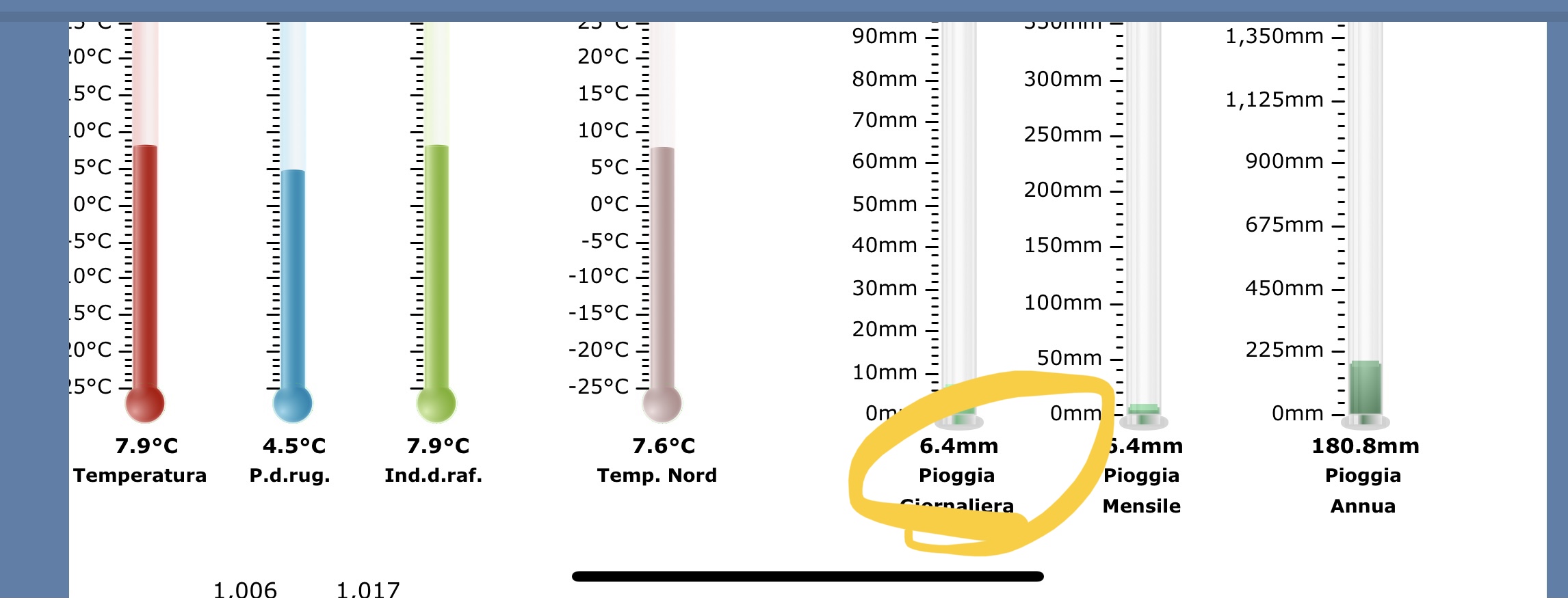

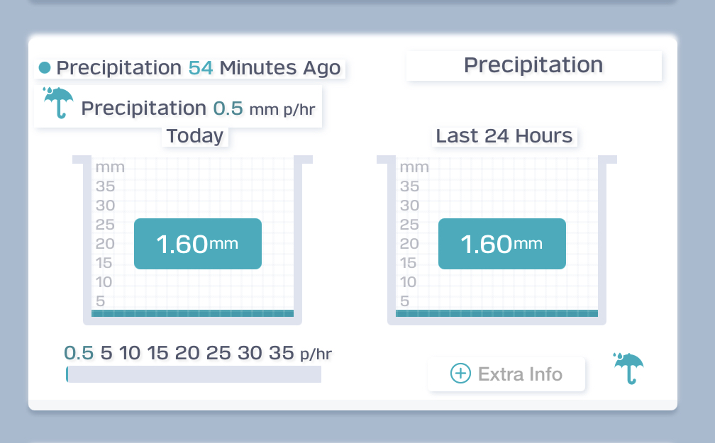

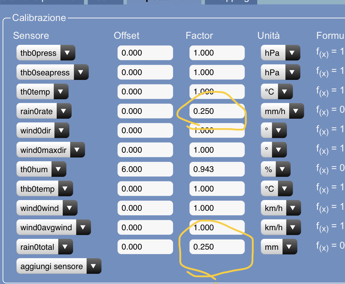

Good morning. I have updated the meteobridge TL-MR3020 and I have problems with the rain0total sensor on meteoplug cloud graphing. My station is an Oregon WMR200 and I use a funnel for rain. For rain0total I set a factor of 0.250 but it is not respected by meteoplug. I attach photos. Thanks.
