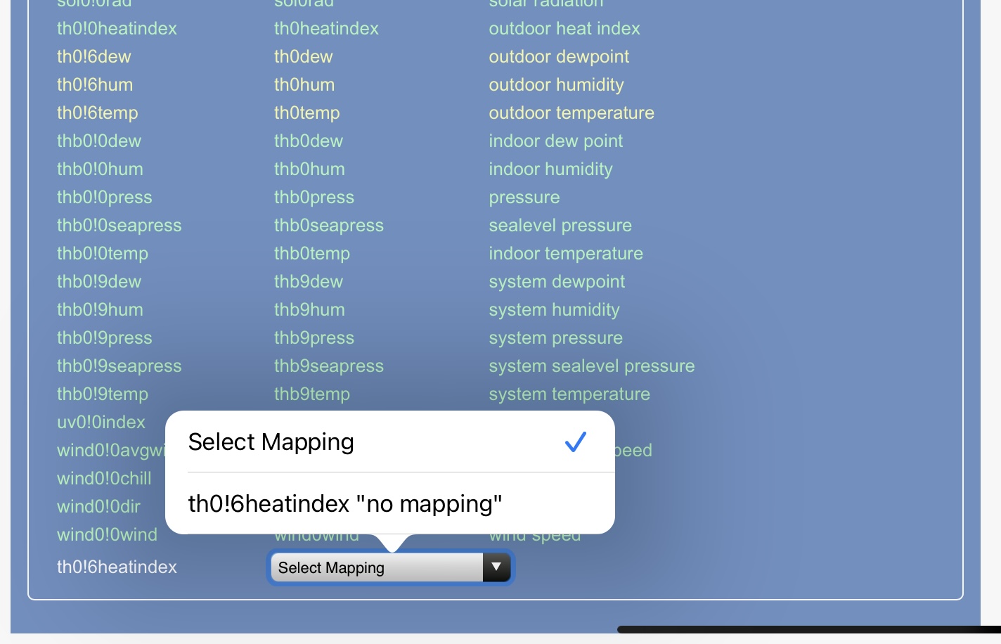

Ive just got a MBP Red and am having an issue with sensor mapping.
My setup is a Davis VP2 with 3 x transmitters:
Ch6: Temp & Humidity only. (MBP type Temp & Humidity station)
Ch7: Wind, Solar & UV. (MBP type ISS)
Ch8: Rain only. (MBP type Rain Station)
All sensors are mapped by default, except the temp/hum on Ch6.
When I try to manually map them on the Station Mapping tab, I can do temp, dew & hum fine. HeatIndex doesn’t seem to work though, there isn’t the option in the drop down box for th0heatindex, see screenshot below.
The behaviour is the same for Ch6 being type ISS as well; have I missed something?

As I cannot test that on my rig, could you please provide me a remote login? Please send URL and password to "info(at)meteobridge.com".

Re: MBP Red Mapping Issue :: Now Fixed
Post by Snapper »
Fixed by firmware update - thanks Boris :)
