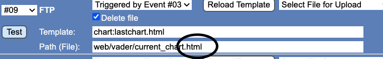

Are you sure you have not forgot to enter the extension in the upload? The .html must be there.
MacOS and other Unix/Linux operating systems have some permission settings for each file. One of these settings is the execution-bit. If set, the file is treated as an executable file. I did some tests with this bit and extension, however I could not really recreate your issue.
But do check the settings in the meteobridge/services first:

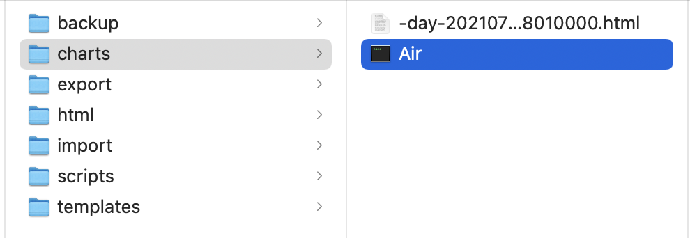

Bart
Posts: 128
Re: Charts: Creating an EXE instead of an HTML
Post by Bart »
Example created file 08.52.36.png (61.45 KiB) Viewed 2854 times
I have set up a few html uploads on my MB NanoSD. I use the command you suggested. On the MB RPI ta file is created that is not seen as a "last-file" as intended. If I double click on it, nothing happens on MacOs, the content is indeed convertible with BBedit to a (also for browser) readable HTML, see 3th post.

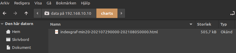

I did try the same thing on my Nano; a custom graph -> create -> export.
The .html is added by automagic. You obviously have tried this also with your Nano.
Possibly this is a Raspberry-issue?? Unfortunately I have no installation of Meteobridge on a pi to test on. :(

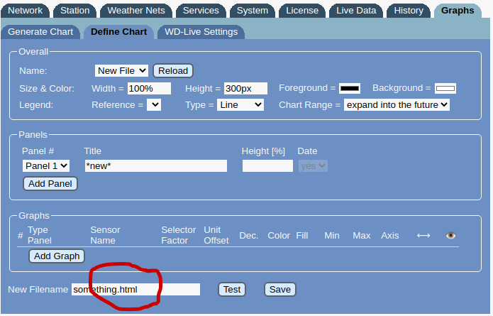

Just for test, is it possible to add the .html already at the chart's definition page? Will that work or make difference?
Definition:
Skärmbild från 2021-08-04 10-32-06.png (56.66 KiB) Viewed 2849 times
My test, (that seem to work):
Skärmbild från 2021-08-04 10-38-47.png (18.78 KiB) Viewed 2849 times

Hopeful I added .html to the file. I had completely forgotten. Stupid of me, keep looking over that. But that still didn't work. So I defined a whole new graph. And that turned out to be the solution.
Now upload it to my site and that's it. I posted this issue here two months ago or something. I thought it was indeed an MB RPI problem because it works on my NanoSD. Felt like a voice crying in the wilderness. And that's because I forgot something so simple. Thanks for the suggestions and thinking along Svampen.

Thanks to you I added the “.html. I suppose that the MB Rpi makes (unix) an executabel if you do not add a file extension.
