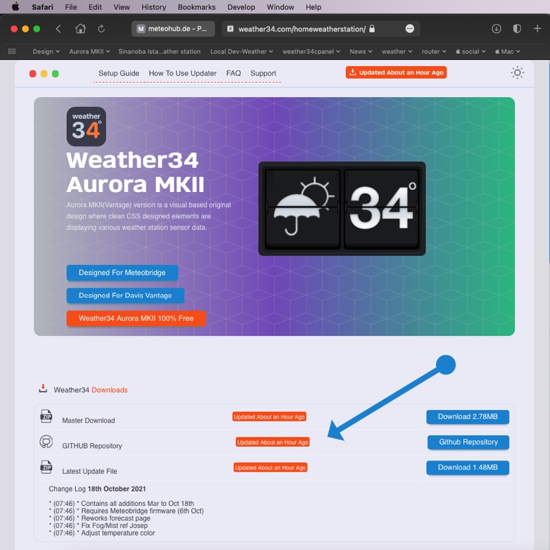

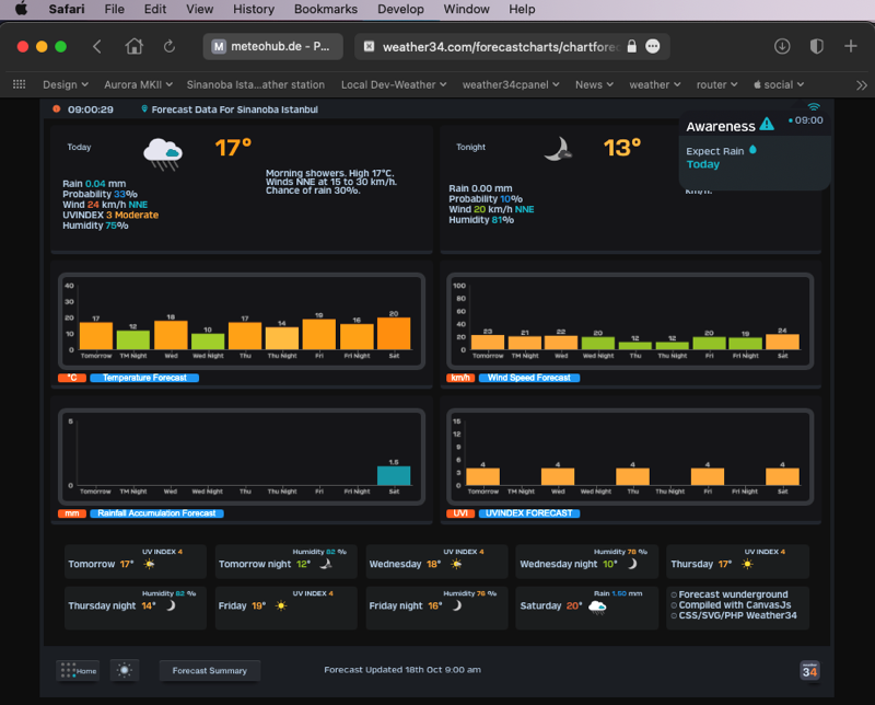

glad you like the forecast layout, somewhat easier on the eye and works nicely or better in phone mode . Ref purple air I will go get it next week it is in customs and requires import tax and ID card verification and as the new customs office moved to the new airport location so a 100km round trip for me now , I will go there when I drop my wife off at the airport its her first overseas flight in almost two years for obvious reasons.."so kill two birds in one stone ".
@all updates will be very sporadic now for the foreseeable future perhaps once a week if something is required , GITHUB will continue to receive updates instantly as and when ideas or fixes are done as it simply synchronizes with desktop application instantaneously .
The download page and additional pages for setup etc got a complete rework in design and hopefully somewhat easier to follow .
Change Log 18th October 2021
* (07:46) * Contains all additions Mar to Oct 18th
* (07:46) * Requires Meteobridge firmware (6th Oct)
* (07:46) * Reworks forecast page
* (07:46) * Fix Fog/Mist ref Josep
* (07:46) * Adjust temperature color
bottom section of forecast page reworked for better device use

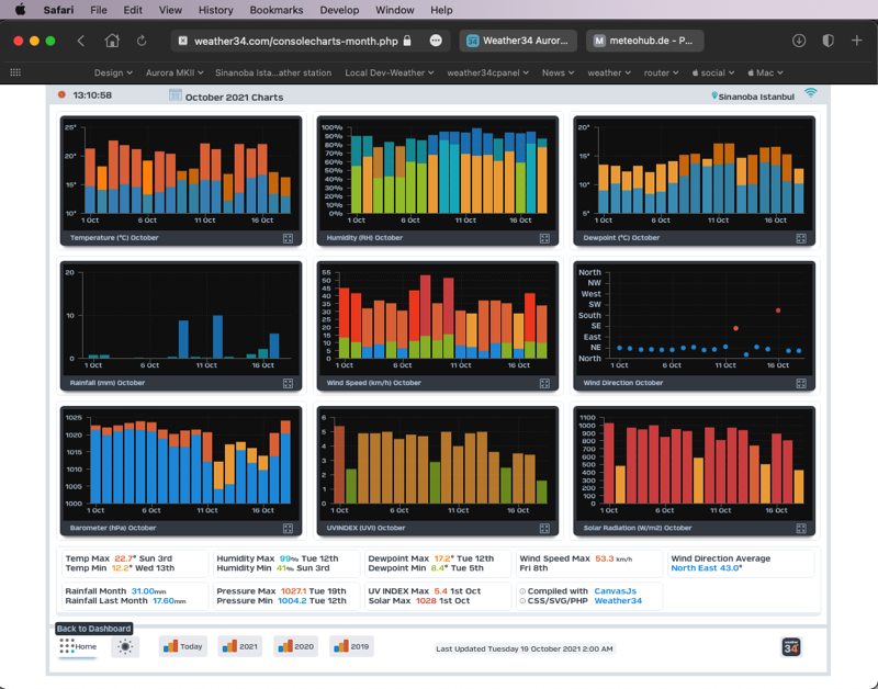

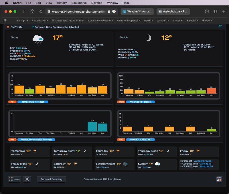

Last minute update Im going to be very preoccupied for a week or so(new boat and new adventures) , so the update 19th October contains all the ideas of chart views that would have been present in paid idea mentioned in August .
I hope this fulfills that need for data or present more ways to see some data
some screenshots as usual below
Change Log 19th October 2021
* (13:04) * Contains all additions Mar to Oct 19th
* (13:04) * Requires Meteobridge firmware (6th Oct)
* (13:04) * Adds max/min values to chart pages
* (13:04) * Reworks chart view border frames
* (13:04) * Reworked forecast page
* (13:04) * Adjust temperature color
the max/min/totals are relevant to the current day , month , year chart page you are viewing

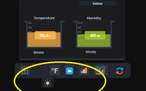

Good morning Brian.
Desalination of the lower bar in vertical mode.

Thanks !!!
Fixed, for the quick reply.

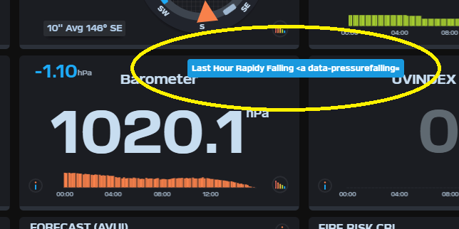

If the condition is "pressure going down rapidly, this appears:
Tnx.

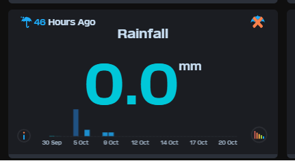

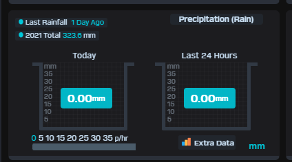

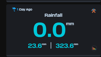

Hi Brian differs from rain ago. on weather34-os2-tablet.
- Sin título.png (9.07 KiB) Viewed 5613 times
- Sin título3.png (11.6 KiB) Viewed 5613 times
- Sin título1.png (17.55 KiB) Viewed 5613 times

Hi Josep
thank you for raising those last few days , somewhat preoccupied but those are mostly very minor mistakes on my behalf that are reasonably easy to resolve.
anyway the OS/Alt theme has really turned out as expected finally something with an outcome Im happy with.so thank you for the prompt highlighting of mistakes..
Change Log 21st October 2021
* (16:17) * Contains all additions Oct 1st to Oct 21st
* (16:17) * Requires Meteobridge firmware (6th Oct or later)
* (16:17) * Align rain timeago across modules Ref Josep
* (16:17) * Rework svg trend arrows
* (16:17) * Adds all features added to GITHUB master
* (16:17) * Reworks all temperature colors in charts
* (16:17) * Fix pressure rapid falling trend Ref Josep
* (16:17) * Fix icon alignment in mobile Ref Josep

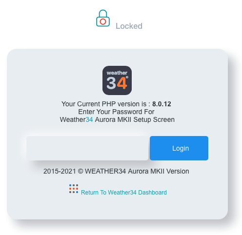

thank you
for the PHP conscious
latest PHP 8 (PHP 8.0.12 verified template compatibility October 21st 2021).

Hi everyone, an information to recover the password Weather34 Aurora MKII Setup Screen how to do it?
- jasonmfarrow
- Posts: 255
Login to your website hosting area and look at your website files in the directory where you uploaded the Aurora MKII template.maltempo wrote: Fri Oct 22, 2021 1:59 pm Hi everyone, an information to recover the password Weather34 Aurora MKII Setup Screen how to do it?![]()
You need to view the console-settings.php file which will have the password that it's checking against in there. This file is editable but great care should be taken as it could kill the whole template if the php formatt of the file is disrupted.

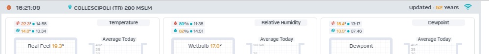

thanks, another information, the upload time remains fixed at 52 years from the attachment .. why?jasonmfarrow wrote: Fri Oct 22, 2021 3:00 pmLogin to your website hosting area and look at your website files in the directory where you uploaded the Aurora MKII template.maltempo wrote: Fri Oct 22, 2021 1:59 pm Hi everyone, an information to recover the password Weather34 Aurora MKII Setup Screen how to do it?![]()

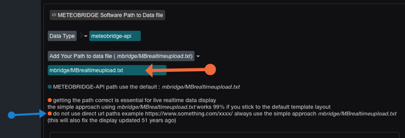

in the setup screen just use mbridge/MBrealtimeupload.txt ... don't add or do not use urls like http(s)://something/mbridge/MBrealtimeuplaod.txt that's what causes the 51-52 years ago on some server configurationsmaltempo wrote: Fri Oct 22, 2021 4:25 pmthanks, another information, the upload time remains fixed at 52 years from the attachment .. why?jasonmfarrow wrote: Fri Oct 22, 2021 3:00 pmLogin to your website hosting area and look at your website files in the directory where you uploaded the Aurora MKII template.maltempo wrote: Fri Oct 22, 2021 1:59 pm Hi everyone, an information to recover the password Weather34 Aurora MKII Setup Screen how to do it?![]()
so its easy to just use the simple mbridge/MBrealtimeupload.txt that's all is needed as explained in the setup screen. shown below...Brian
