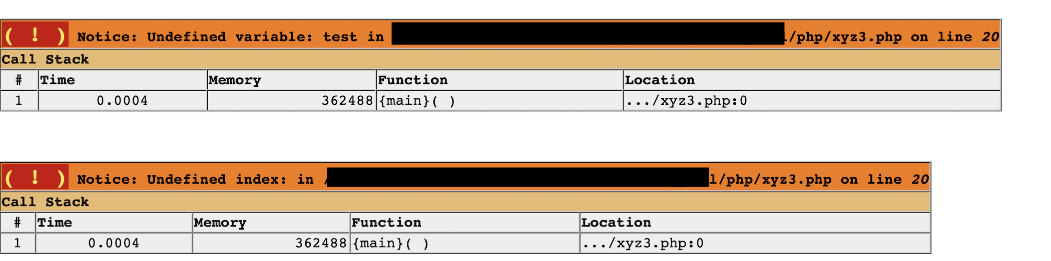

Re: Barotrend and Enbarotrend
Now there are some other remarks..see attachment.
- Schermafbeelding 2022-05-20 om 10.57.33.png (492.82 KiB) Viewed 4868 times
No attachement to check?
Sorry for the wasted time for both of us.
https://www.php.net/manual/en/function.file.php read part Parameters => Flags
Just change your file() in your script from
$test = file($myFile);Code: Select all
$test = file($myFile,FILE_IGNORE_NEW_LINES);I overlooked when you posted all data on one single line
Array[0].....[117] => -2 [118] => FF.... (btw, [117]=barotrend)
Typo, line 20 should read
{ $result = $arr_vals[$key];} // the contents of field 118 is knownRe: Barotrend and Enbarotrend
It is reading correct now:
23 Trend data >RF< translated to >Rapidly Rising<

It seems to work Wim, thanks for the persistence. It is not always easy to communicate via a typewriter in the form of the internet.
Bart
