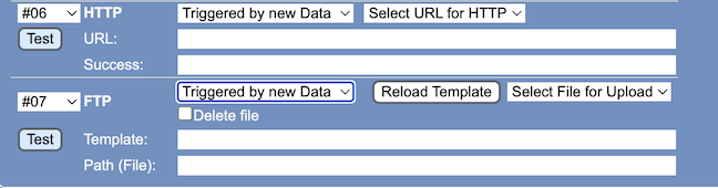

You could do that by using event-trigger "new data".
That is triggered for all station-data items, not for a single one.
Put all data items in 1 HTTP upload and the receiving script could check if there are items which need to be processed.
Schermafbeelding 2022-07-25 om 13.27.54.png (42.19 KiB) Viewed 774 times
