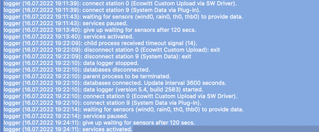

Just picked up a WS-2000 the other day and I am currently trying to connect to my meteobridge running on my RPi and am having no luck getting the two to "talk" to each other. On my Ambient console I have set the following:
State "Enabled"
Protocol Type "Same As AMBWeather"
IP/Hostname 192.168.xx.xxx
Port "80"
Interval "60 second"
Path "/public/ecowitt0.cgi"
I have included a screen shot of my station tab and log hoping that might be helpful. As a side note, I have also tried a couple variations of the IP/Hostname: http://192.168.xx.xxx as an example and have also tried a couple variations of the path name in addition to adjusting the interval.

Quick note, when browsing to http://meteobridge-ip-address/public/ecowitt0.cgi the page response is FAILED.

- Station Tab.png (12.8 KiB) Viewed 1938 times
- Log.png (111.16 KiB) Viewed 1938 times
