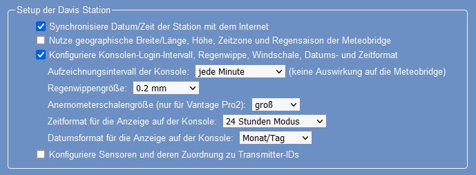

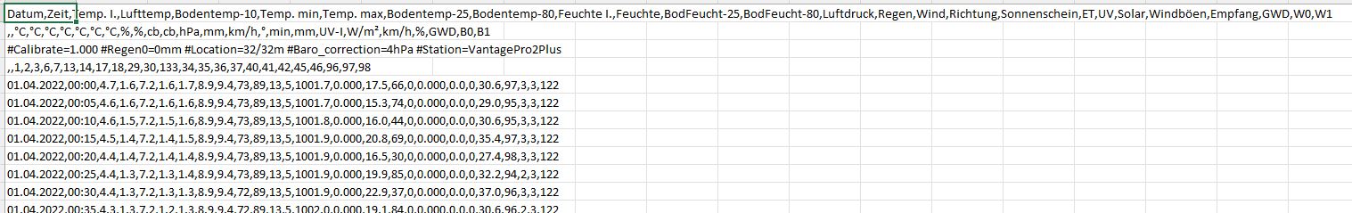

Import file has been a csv file from wswin directly. Pls. see screenshot:
Importing interval is set to 5 min.
My MB is set to archive minute data (see screenshot).
