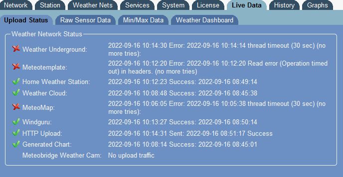

For months i have this problem on RPI , data not being uploaded to various weather networks...
I restart RPI , data is ok for 1 minute , after that is not uploading , as seen in the atachments...
Meteobridge has latest update...
Any help would be much apreciated , thank you !
In the pictures you can see 30 minutes no upload , in the second one , 2 hours with no upload , regardless the Meteobridge says "Succes" !

Re: RPI Meteobridge not uploading to Weather Networks
Your RPI Meteobridge has severe problems to reach the Internet as you can see from the timeouts.
Is it LAN or WLAN? Anything special to know about your provider? Satellite or mobile or alike?
it worked well for i think more than 2 years , my internet is gigabit , RPI is wired conected to router , so i think this might not be the issue...(but i look into it)...
anyway i change the network to wifi just to check...same thing....

you can connect into my MB if you want , just to check ?
yes, I would like to check via remote login. Please send credentials to "info(at)meteobridge.com".
Inspection identified two issues:
1) a high retry rate on weather networks that are triggered in short intervals and
2) a HTTP upload to a website that does not answer and runs into a timeout after 30 seconds
both issues filled up the queue of upload tasks and delayed operation.
After fixing that uploads went fine (except for the non-functional HTTP upload that was disabled).

Re: RPI Meteobridge not uploading to Weather Networks. **solved**
Thank you very much for the help !
1) a high retry rate on weather networks that are triggered in short intervals .... i modified the uploads retries just few days ago in order to see what will happen , before was with "no retries" , or few....
Anyway now its all fine , thanks again...
