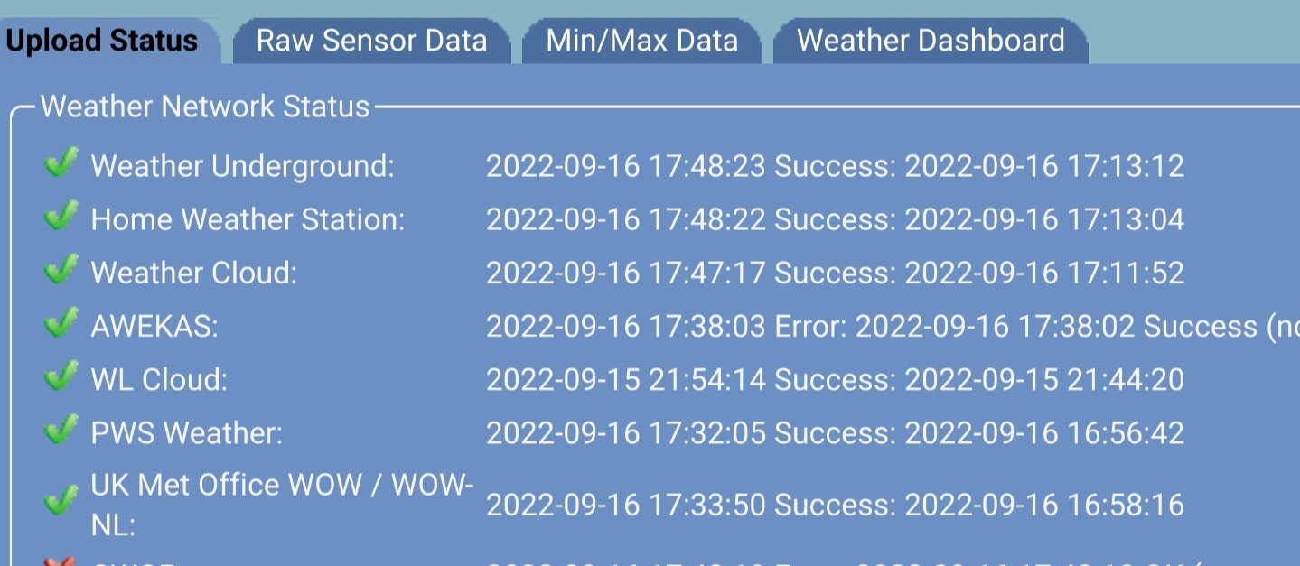

My uploads to WL cloud and WD live ftp upload stall and do not occur
After reboot it will upload but after sometime it just quits
In the Upload status bar a green tick is seen but the times of successful upload are outdated
Really strange as I use client raw files on my site and my values aren't updated
All other uploads are just fine but the "Succes" time is older than the upload time
WD live and WL cloud upload stall
- IMG_20220916_181818.jpg (325.63 KiB) Viewed 1084 times

Re: WD live and WL cloud upload stall
Lately problems are growing with my meteobridge Nano SD
Buffer fills up to 100% seems like a network problem
Now gone back to version 5.2 but my guess is that will not solve anyting
Also WD feeds are stalling still
I will disable these to see if that helps
Years with no problems have passed but now problems are growing
What is the upload interval and retries?
WL cloud interval is 1 minute with no retry
WD live I do not use momentarily
I use now version 5.2 of meteobridge and upload is ok now but I'm not sure if the latest version is the culprit.
I'll see how long it is uploading correctly, also my buffer is now ok, also changed setting in network to 802.11g only
Very strange maybe the weatherlink site is not responding the way it should sometimes
I'll keep you posted
