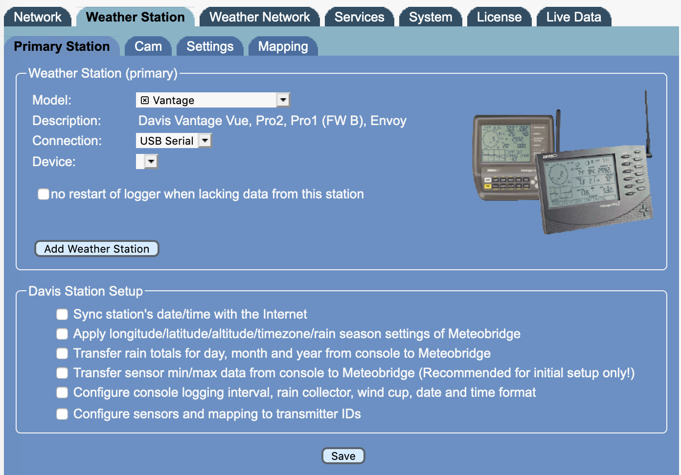

I notice that the log shows your station as devMH. Since you’re connecting your console to your tplink via USB I think your connection type has been corrupted. Check your primary station device setting under the station tab and see if it’s still set to USB.

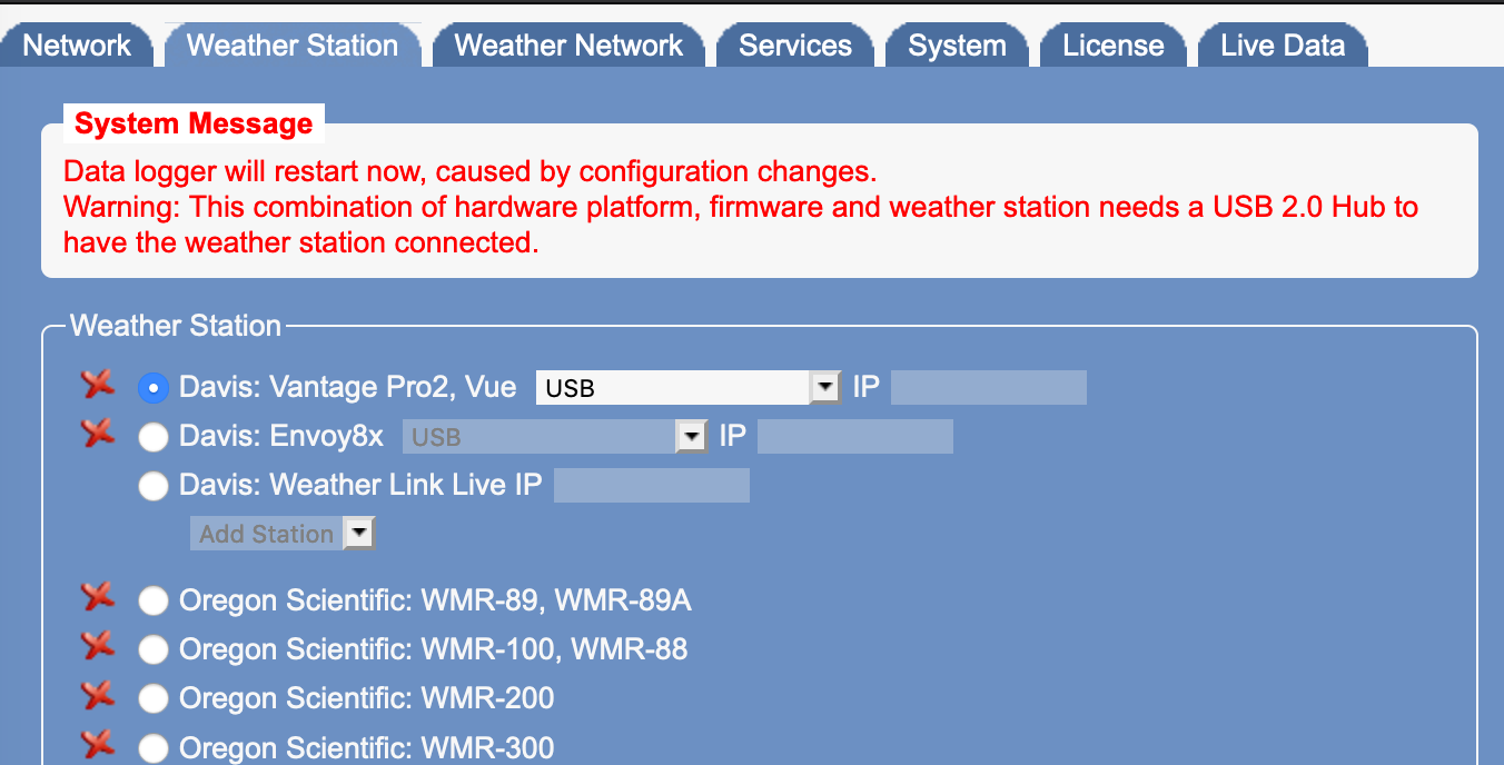

Thanks for the suggestion. I confirmed it is set to Vantage and USB Serial (screen shot attached). You can see no "device" shows up (the list is blank). I also tried rolling back to v4.2. When I did so, there was no primary station set any longer. I set it to Vantage Pro 2/USB and saved it (2nd screen shot), but same thing as on 5.x:
logger (28.12.2020 21:40:14): can't open device /dev/ttyMH: No such file or directory
system (28.12.2020 21:40:38): stop of logging process initiated.
logger (28.12.2020 21:40:44): can't open device /dev/ttyMH: No such file or directory
system (28.12.2020 21:40:45): start of logging process initiated.
logger (28.12.2020 21:40:45): historical data loaded (20 records).
logger (28.12.2020 21:40:45): data logger (version 5.1c, build 13350) started.
logger (28.12.2020 21:40:46): can't open device /dev/ttyMH: No such file or directory
logger (28.12.2020 21:40:49): waiting for sensors (wind0, rain0, th0, thb0) to provide data.
logger (28.12.2020 21:40:49): services paused.
logger (28.12.2020 21:41:16): can't open device /dev/ttyMH: No such file or directory
logger (28.12.2020 21:41:46): message above repeats 1 time.

Is it possible your USB hub ( which is required ) has failed ?. If you have a spare you might try switching it.

Greetings! Just wanted to close the loop on this - the USB hub did indeed fail. I replaced it and everything is good again. Thanks for your help!
