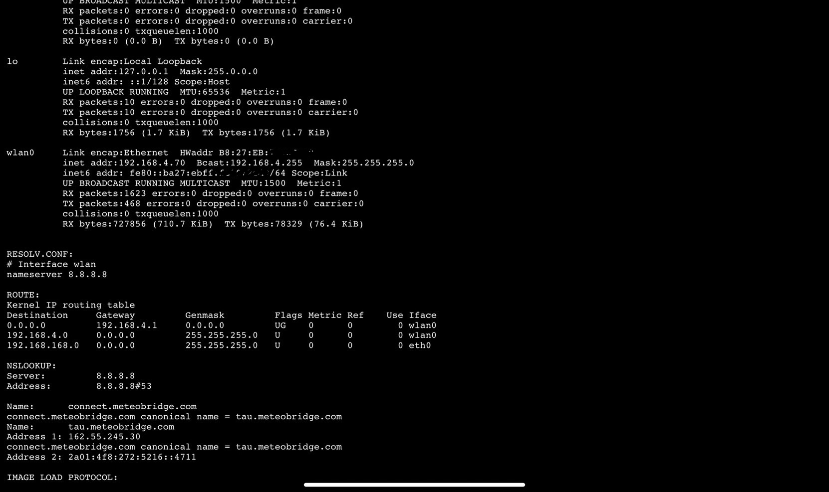

My Metrobridge run almost 6 months without reboot on RPi 3B until I had to shutdown and replaced the UPS battery last week. After restarting, it stuck at IMAGE LOAD PROTOCOL with red light blinking at RPi. The DNS is ok and I can ping both connect.meteobridge.com and tau.meteobridge.com.
Still not reinstall the image since I'm not sure that the statistic and config will be lost or not.
Do I miss anything?

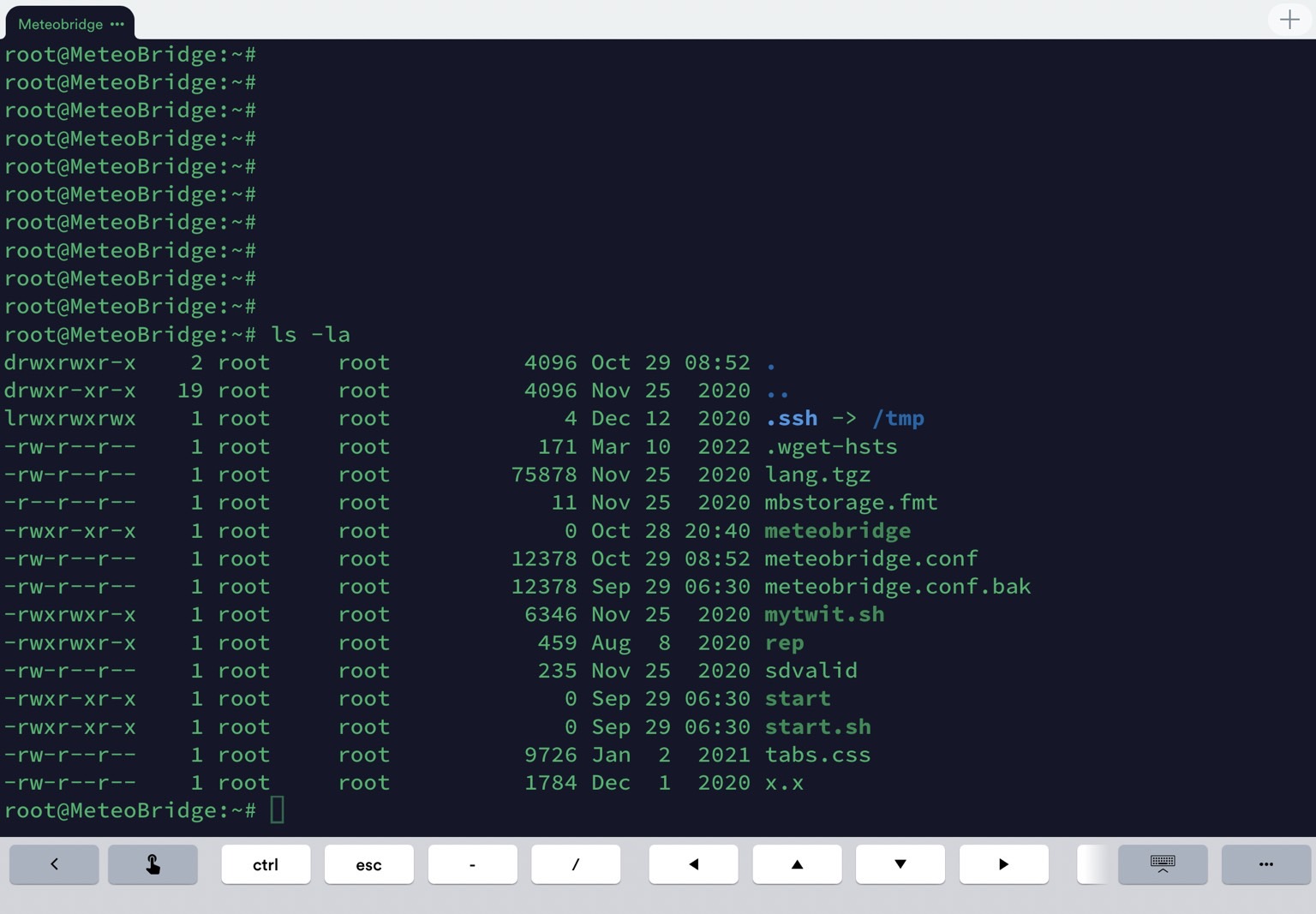

OK. I managed to make it works again.
I get those 0 byte file from a fresh image of the Metrobridge .img and put it on that directory.
Reboot and it works.
I think it is a good idea to have a fresh install so I export the database and configuration file, did a fresh install sd image then restore both. Now it is OK.
