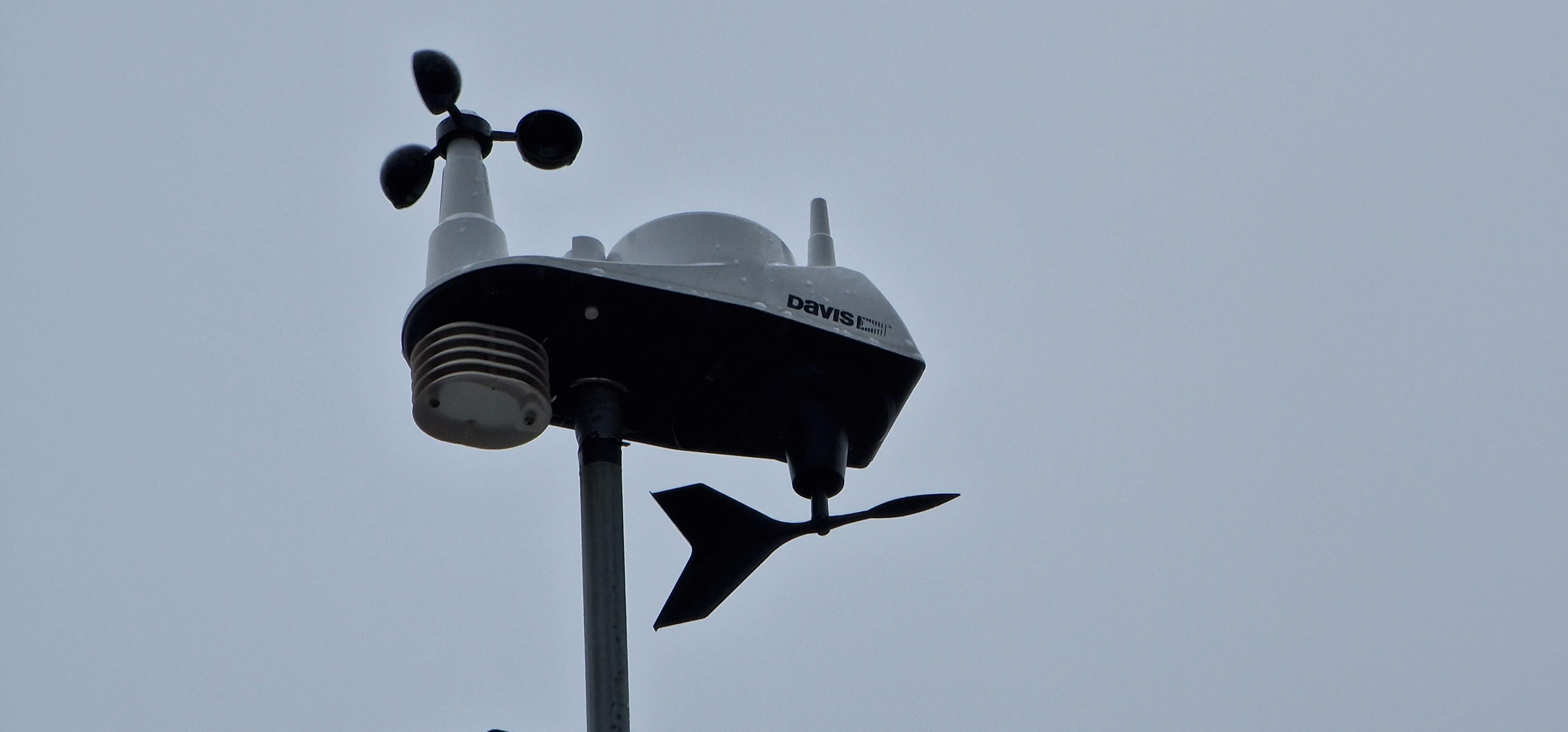

Picture in the attachment. It looks like the Vantage Vue.
Looking at the prices, I think that we will go with the same model (Vantage Vue) as this is providing all the info that we need (mainly wind speed, direction and gust)
We don't use the console, just the Vantage connected to MBPro via RF link. No logging, just pushing data to Windguru and adding the above parameters to the picture of the webcam.
