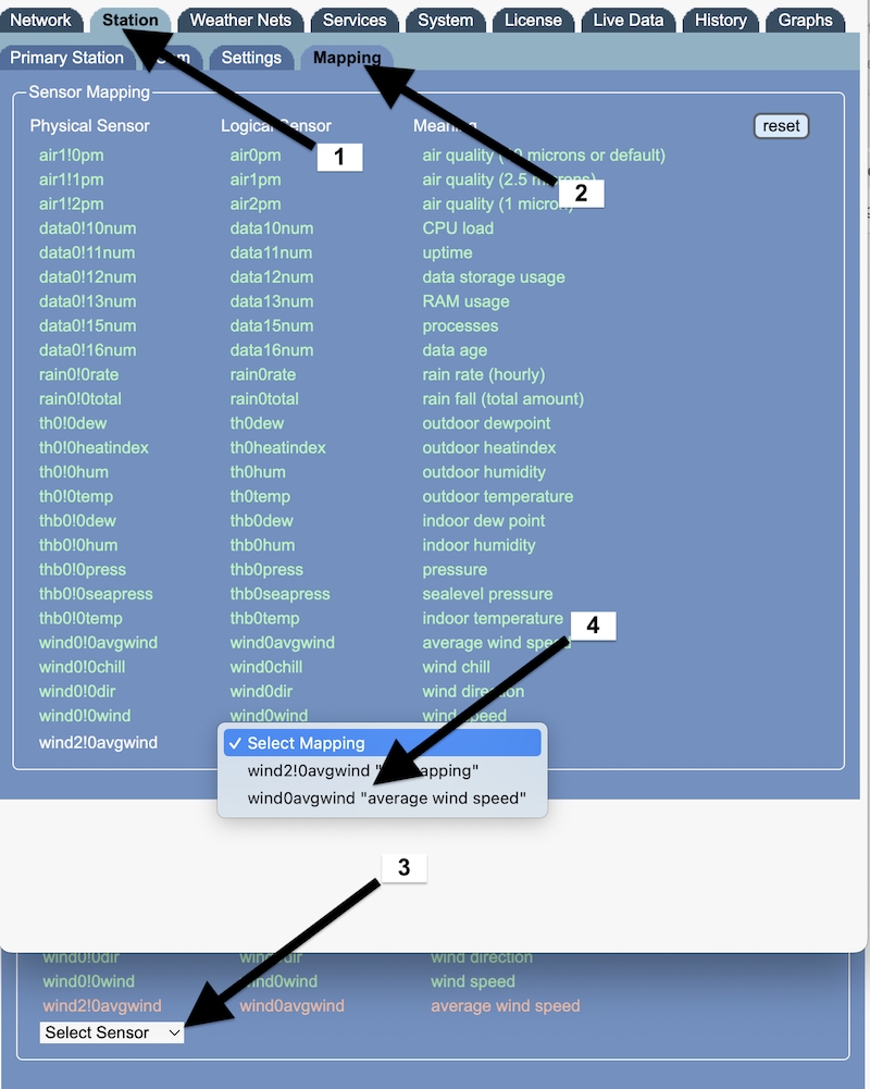

Normall the primary sensors are used.Stebi wrote: Tue Mar 07, 2023 11:49 am I have 3 weather stations (Weatherflow, Ecowitt and Davis Air Link) connected to my Meteobridge. How can I manage the data which is sent to the different weather networks? Is all the data going to the networks or just the primary station?
Greetings from Basel
Thomas
F.i. with your 3 stations toy have three temp/hum/pressure sensors, on for each station.
normally the system assumes you want to use the first station as your primary.
But on the Station -> Mapping tab you find a dropdown selecter with all sensors Select one and assign it as your primary sensor.
- Schermafbeelding 2023-03-10 om 20.21.31.png (432.64 KiB) Viewed 1267 times
Re: Weather Networks with different weather stations
that's in principle true, but it doesn't solve the issue that only one station at a time can be chosen for all the weather networks - howsoever you match the sensors.
If e.g. you want station 0 (primary) to post to WU and station 1 to post to AWEKAS and station 2 to post to WOW, you cannot do this with matching.
With matching you can only replace one station by another or(, if this is wanted,) mix values from different stations into one post
