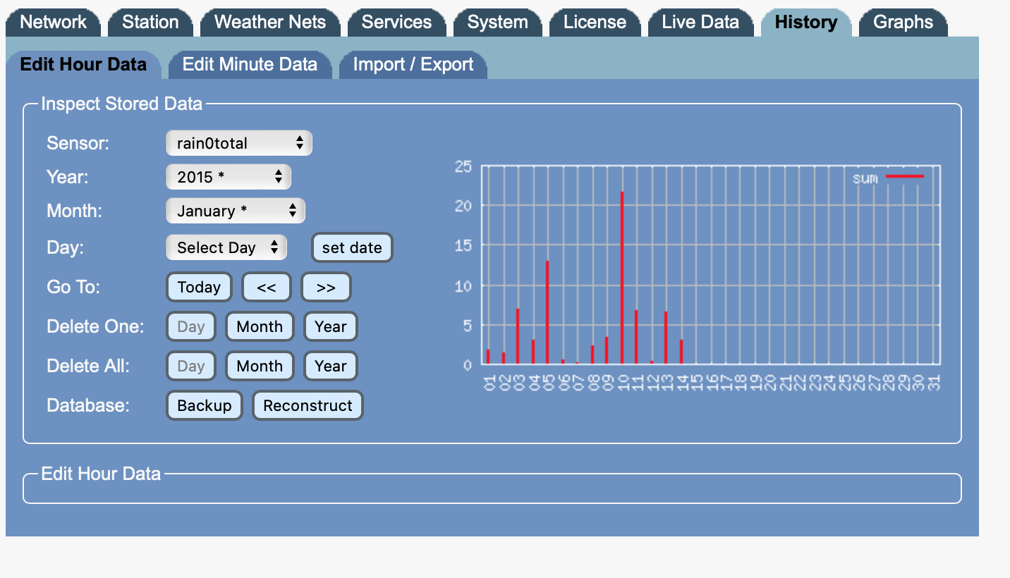

I'm experiencing some failed spike with rain0total when Importing old meteohub data (2015) on my meteobridge
Platform: Raspberry Pi 3 Model B
SW Version: Meteobridge 5.6 (Mar 11 2023, build 2709), FW 1.3
per-minute data are used
when importing the meteohub RAW file for a month, the import is processing well.
The issue is when I'm inspecting the data imported:
I see some wrong spike for raintotal

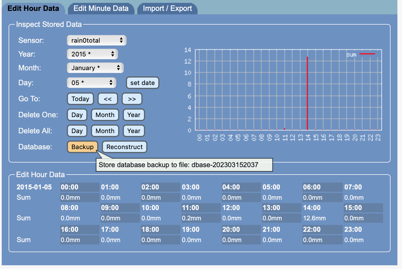

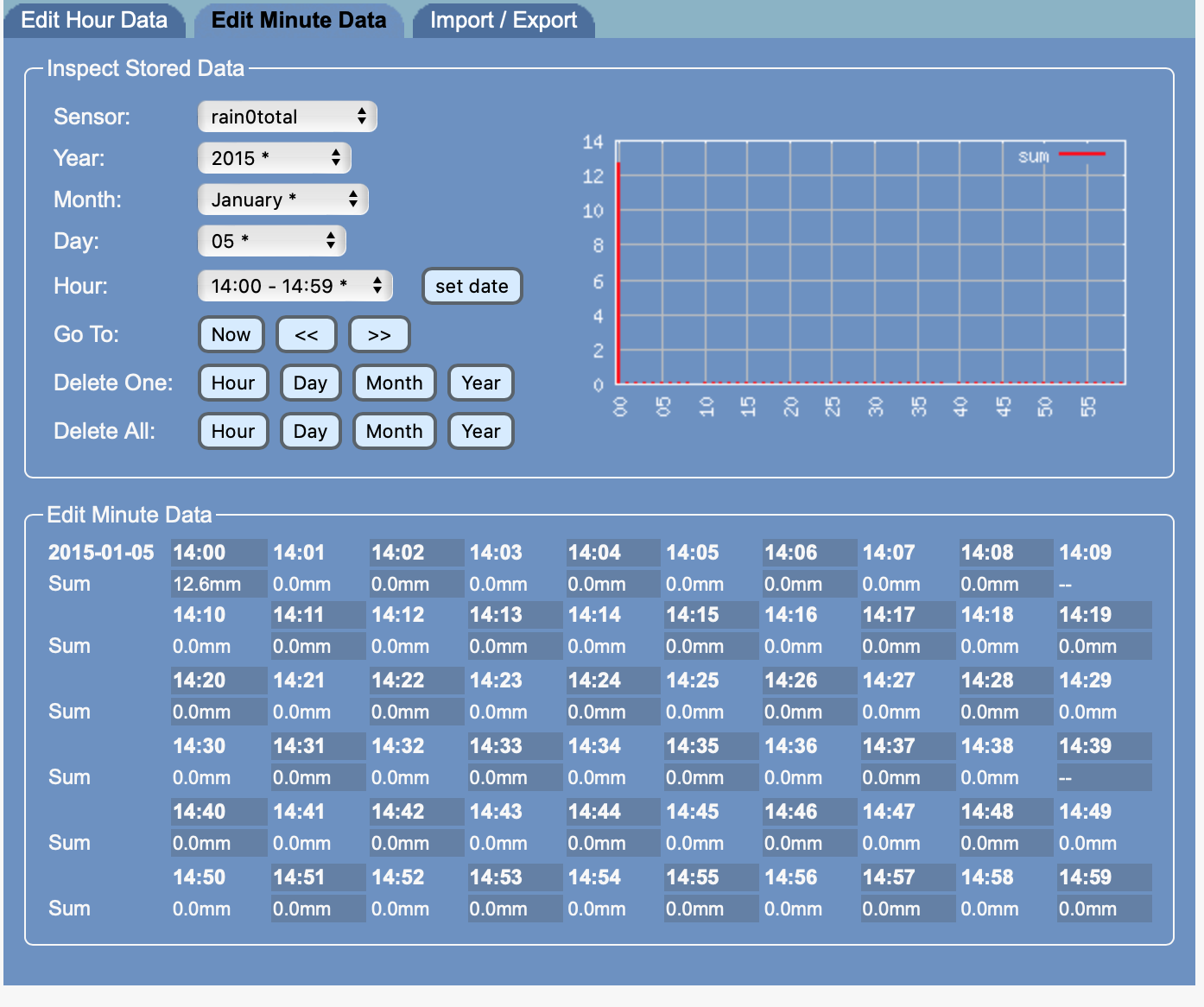

here is an example for 5 Jan 2015 (the spike is at 14:00) => 12,6 mm are reported (it was not such raining at this time)

I was initially thinking of a meteohub corrupted Raw file (bad sequencing for rain0total value): it is not. the files is fine
it's look like their is a "stack" counter which is flushing at a time in the code
I've this behavior a lot of time for a year period imported, which is ruining the precipitation data

obviously the same amount of rain was already there earlier, first registration of 12.6 mm was at 20150105103040.
There it should show.
Assuming that the time stamp is UTC, the increase from 12.4 to 12.6 shows correctly in the 11:00 hourly window.
The 12.4 mm had been taken over from 20150504 - where they shouldn't have been in the first place if this was a daily count.
I don't know what rain0 x y z means. If the z stands for monthly count, the increase was taken over correctly. If it was daily, it should have been reset to 0 at midnight.
Anyhow, it looks like it was wrongly interpreted by the import program - there is not visible reason in the data import file for me why to add 12.6 mm at 14:00 ...
Possibly a bug ...

Re: Raintotal failed spike during import meteohub data
I was able to identify the error. It has to do with Meteobridge importing the file in chunks and rain totals as a cumulative value is not handled correctly when starting with the next chunk. Just released version should have that fixed, please also read here (April 22, 2023): https://meteobridge.com/wiki/index.php/Forum
