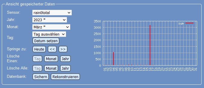

Since one of the last bugfixes, wswin import was working fine.
See also viewtopic.php?t=16376&start=15
But currently, with Version Meteobridge 5.6 (Mar 11 2023) it is again not working.
Scenario: MB Pro after reset, empty database, import of January – March 2023 from wswin.
MB Pro has some peaks in Rain and temperature. Rain sum is 80892.8mm and Temp Max 95.0 °C

Unfortunately this point is still open, wswin Import is not working. Please solve this issue.
Re: Again, wswin import is not working
When you send me an import file that results into these errors I can try to reproduce your situation.
Your headline tells "Import is not working". Is that rue? Or is it more about some entries not imported correctly?
