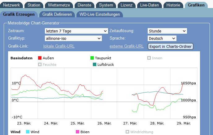

I have the impression that the weather data for the graphics in the MB-Nano SD are no longer recorded when the WLAN connection is temporarily interrupted. Or is there another reason the recording gaps? In the period shown, the MB was switched on and measured values were displayed on the console.

Can you please inspect the uptime (data11num) with a graph to verify that NANO was really operational during that period?

wws-rs wrote: Wed Mar 29, 2023 11:48 am I have the impression that the weather data for the graphics in the MB-Nano SD are no longer recorded when the WLAN connection is temporarily interrupted. Or is there another reason the recording gaps? In the period shown, the MB was switched on and measured values were displayed on the console.
I have seen this too, when I changed ISP a couple of weeks ago I lost an hour of data. My console is a wired one so I thought it would just record over the loss of wlan. Although I do use a separate access point so the SSID would have been there all the time with no Internet access.

I have an MB-red running and recall it happened to me as well in the past. Wifi not operating or wifi connection lost for a while and no MB data recording for that period in hindsight.

Today it happened again. WiFi got down due to unforeseen fibernetwork repair started during the night. I properly shut down the MB Red thru pinhole button in the morning to connect it to a different ADSL based WiFi network. Once up and running all data appeared lost for the period between fiber WiFi stop and ADSL WiFi start.
