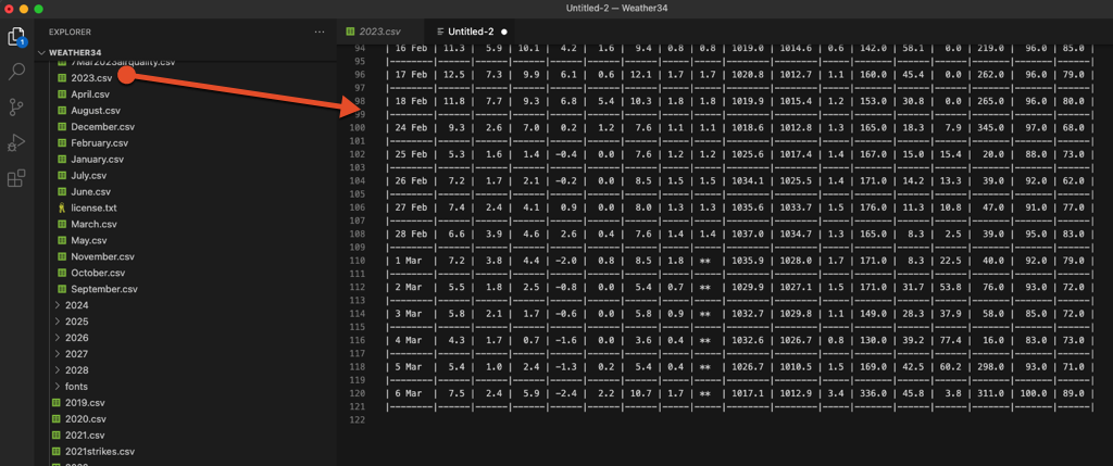

Hello if you can export the data from weather link into a text with commas or csv format file I can simply apply a local script that will convert your old data to a weather34 csv chart format .please note the template only supports data from 2018 onwards unfortunately not all the way back to 2008 .

format expect each value separated with a comma
position number and data type the position is critical

17 values and it should resemble something like below (don't worry about if you don't use airlink or purple air quality
image below examples what the structure is when viewed in CSV editor .

1 Mar,7.2,3.8,4.4,-2.0,0.8,8.5,1.8,**,1035.9,1028.0,1.7,171.0,8.3,22.5,40.0,92.0,79.0
2 Mar,5.5,1.8,2.5,-0.8,0.0,5.4,0.7,**,1029.9,1027.1,1.5,171.0,31.7,53.8,76.0,93.0,72.0
3 Mar,5.8,2.1,1.7,-0.6,0.0,5.8,0.9,**,1032.7,1029.8,1.1,149.0,28.3,37.9,58.0,85.0,72.0
4 Mar,4.3,1.7,0.7,-1.6,0.0,3.6,0.4,**,1032.6,1026.7,0.8,130.0,39.2,77.4,16.0,83.0,73.0
5 Mar,5.4,1.0,2.4,-1.3,0.2,5.4,0.4,**,1026.7,1010.5,1.5,169.0,42.5,60.2,298.0,93.0,71.0
6 Mar,7.5,2.4,5.9,-2.4,2.2,10.7,1.7,**,1017.1,1012.9,3.4,336.0,45.8,3.8,311.0,100.0,89.0
