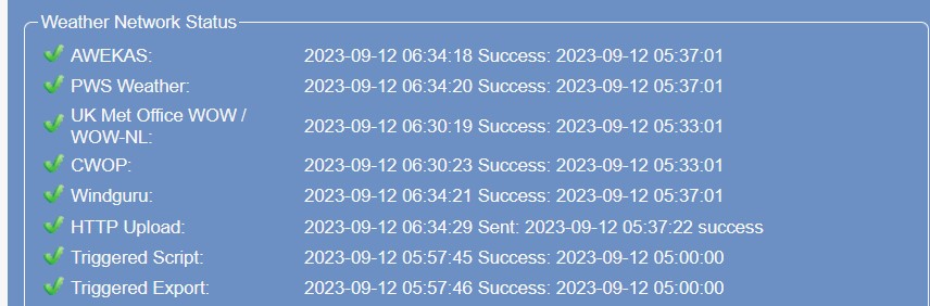

However, as time goes by, the MB RPi posts lag more and more behind - which can also be seen in in the Upload Status
Posting interval: 15 seconds
e.g. after reboot
HTTP Upload: 2023-09-08 16:36:11 Sent: 2023-09-08 16:36:08 success
after 17 minutes, already 3 minutes delay - and it keeps on growing
HTTP Upload: 2023-09-08 16:53:11 Sent: 2023-09-08 16:50:28 Success
HTTP Upload: 2023-09-08 17:03:02 Sent: 2023-09-08 16:58:44 success
that's not the only http upload on my MB PRi (nor on my MB Pro) and the Upload status monitor doesn't say which post it is referring to, but at the the remote server end the delay is also clearly visible.

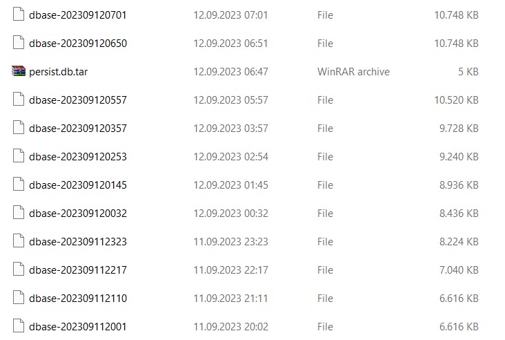

the posting gets delayed, even the start of scripts (.sh) - I have two scripts - one is an hourly backup - even that gets delayed
pressing the "test" button in the events page doesn't show an effect ...
even initiating a backup from the admin page ... - no reaction
Only a reboot helps - for a few hours ....
Somehow this system seems to confuse the time ....
It's starts on time 20:02 and gets more and more delayed.
what in the end looks like three minutes too early is in fact 57 minutes late ...
2nd last entry was a manual backup after reboot, last entry event triggerred script like 11 hours before at 20:00

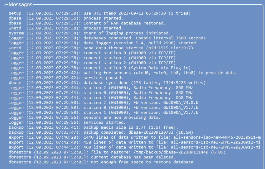

I ran suddenly in a larger number of database issues when MB tried to create records for already existing entries.
Then MB complained of a malformed database imiage.
Doing a sqlite ".recover" and rebuilding the database externally didn't help.
Internally it wouldn't even start the forced rebuilt claiming not enough storage available - which wasn't the case.
The same with a restore. Even with the option to delete the database before restore brought the message of not enough storage.
The databse had a size of 6GB, 8 GB were still free - after the delete 14 GB would have been free.
But the delete wasn't executed ...
That's when I created a new image and startd the database from scratch.
It's hard to believe that all my bakups are faulty. And I went back three weeks.
I can go back 2 years ... will do this in parallel when time allows on a separate MB/RPi install, maybe also going back in MB version ....
Let me see what the new database does, but already the timings are delayed, seemingly ignored, maybe stuck in some queue ...

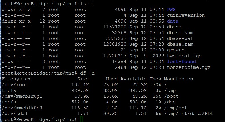

as you can see from the pictures below, MB doesn't tell the truth - neither was the current database deleted (ls -l) nor was there insufficient space (df -h) ....
