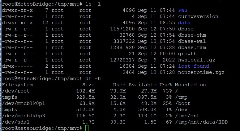

the attached screencopies speak for themselves
nothing works
how to get my atabase restored ??
The message is pure nonsense (or just a secondary wrong message) as there is plenty of space available as the df -h shows
plus the database wasn't deleted as reported
the df -h was executed after the MB message showed in the log
is it that MB cannot handle the restore of large databases ?

Re: MB/RPi - not enough space to restore database - but plenty of space available
As you can see you added an additional mount point /tmp/mnt/data/HDD for your connected drive. Unfortunately, that causes problems with the database restore script, which inspects mount points and gets confused to see something unexpected.
In just released update I made the restore script more robust to that. However, please unwind all you special tweaks when you face an error to rule out that it is a modification you did that is causing the issue. Please be reminded that I only support stock Meteobridge installations, when you modify you are on your own. Thanks!
