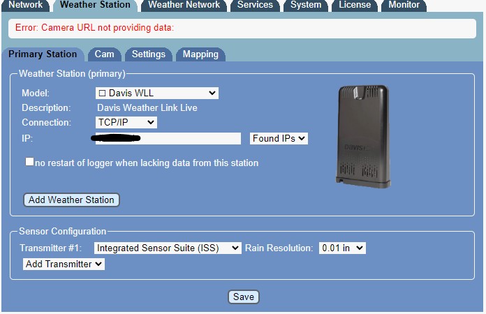

I am trying to connect my Davis WLL to my meteobridge I think I have done everything right putting it in intergrated sensor sweet transmitter 1 but no data is showing up on Wunderground even though I have a green check. How can I confirm the ip address of the Davis WLL? Any suggestions or step by step screen shots would be greatly appreciated!

Pretty frustrating actually as I bought the WLL just to be able to add it to my meteobridge. I have done all the steps and it will not even pick up WU for example. Something is not right either my meteobridge isn’t supported of WLL or i am not sure what’s going on. Maybe if someone who has my meteobridge can post screenshots of there setup. Other then selecting WLL as main weather station I added the IP and then selected transmitter 1 with intergrated ISS suite and hit save. I have the WLL connected via wifi on my netwwork and i am able to send my data to weatherlink live and also see my data on the IOS app without any issues. Sorry for the repetitive post I just would like to get this working.
Ambient Weather WEATHERBRIDGE Universal WiFi IP Ethernet Server for Weather Stations https://www.amazon.com/dp/B00FPPYM7M?re ... 5NHC1YWDZ8
Here below is how i have it setup right now

in your weatherlink.com account, go to your station,
on the right hand side on the wrench icon search for health data, your ip is listed there.
it is not a static ip, over time it can change.
