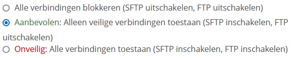

For the time being is this possible by STRATO to accept SFTP and FTP and then it works fine.
Realize its a work around till the moment STRATO stops supporting FTP.
I am sorry it is a Dutch picture and I can not find an English one.
You can find the management:
Database and Webspace ---> SFTP management in the Dutch user environment.
