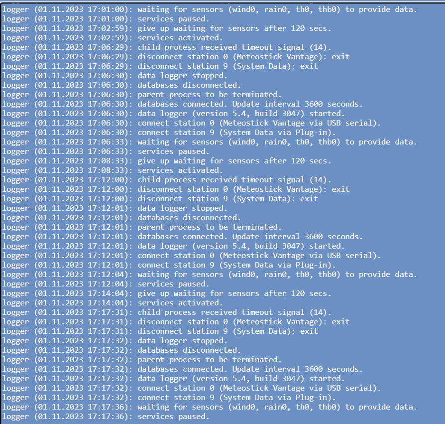

Logs tell that Meteostick is being connected but does not report anything back, like being stalled. How is Meteostick connected to your RPI?
Is it mounted outdoor? Condensing water? Strong RF emitters close by?
