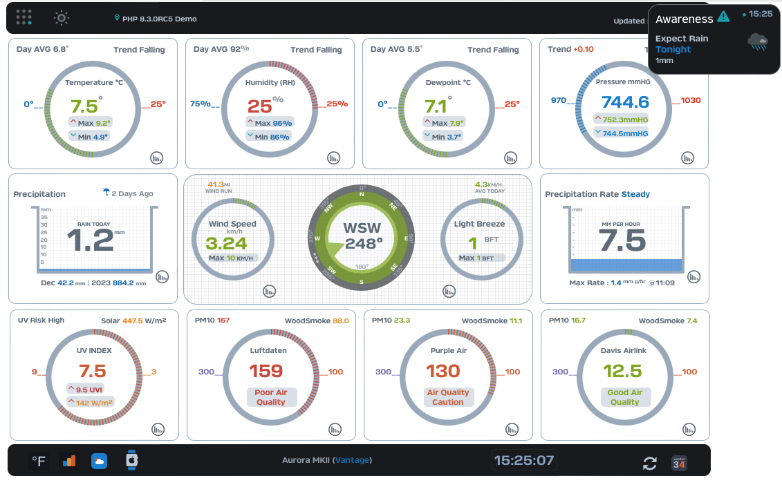

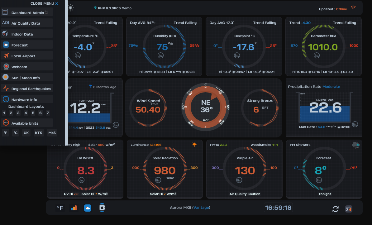

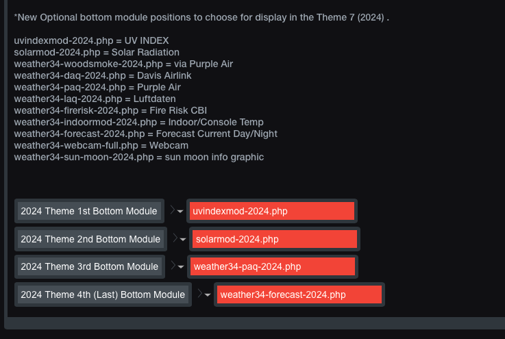

I think this week I will release the simple update .

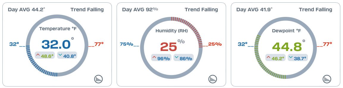

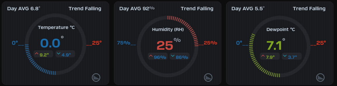

I tried the rain with circular gauges for me it didnt look as good as the rain bucket style and temperamental when throwing inches or mm at it , i think the using the rain-bucket style breaks up the over use of circular and ultimately friendlier to maintain .

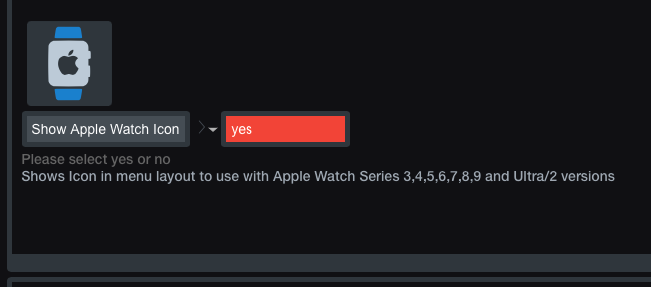

so added options in the setup screen ,moved the apple watch option to bottom bar.
! thanks gary glad you approve :-)
Screenshot at Dec 10 16-59-34.png (280.43 KiB) Viewed 98196 times
Screenshot at Dec 10 18-08-53.png (100.97 KiB) Viewed 98190 times
Screenshot at Dec 10 17-01-41.png (24.07 KiB) Viewed 98196 times

weatherist34 wrote: Sat Dec 09, 2023 9:53 am Id rather take the easy route and apply solid colors , easier to maintain and adapt to various sensor data.
I will adjust the compass , also will try out the rain accumulation and rate ..let you know how it goes ..
thanks for the feedback..
Understood, no problem. You are the main developer and decide what is possible and feasible ;-)
hello Torsten

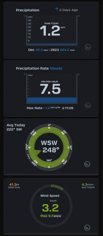

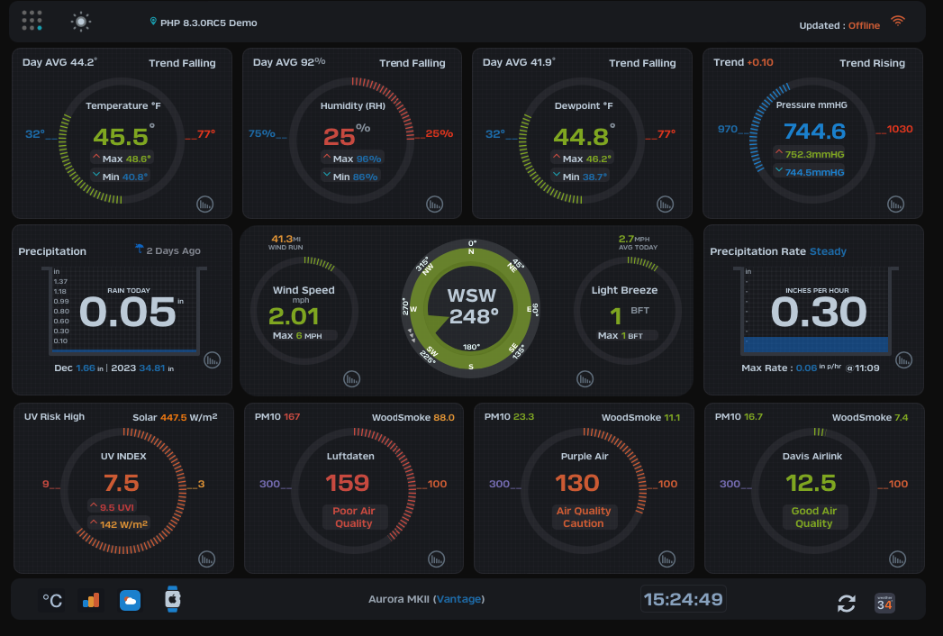

if time permits this week Ill add an option for preference of wind/rain .. that said this is how it is progressing as above it grows on you as you begin to complete/compile the layout according to what I have in my head then I fine tune positioning of various text etc.. :-) ..
as always dark/light modes .. ps Alex i wont forget mmHg :-)

New layout looks great Brian. Happy to help with some user testing if you need someone. Hope you are ok

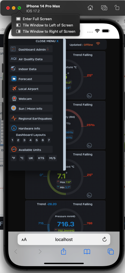

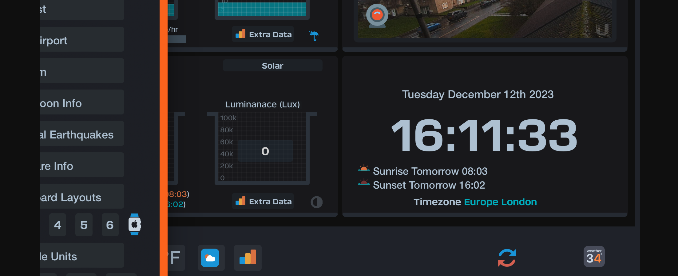

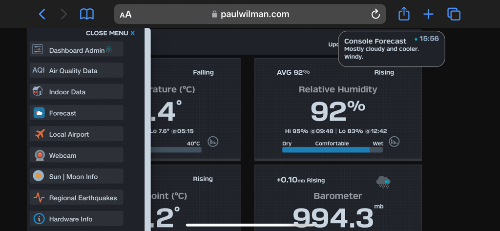

The new update iOS/iPadOS 17.2 last night, breaks position buttons and visible area menu. Thank you Apple :roll:
Torsten ok I'll check that prior to release yet to update mine but not seeing the issue iPhone 14 IOS 17.2 . I have finished 99.9% of it now so leave it to run for a day or so see if I cant find any anomalies .
finished design and has always mobile phone layout works fine,oh and mmHG for Alex I have corrected gauge marker vaues.. :-) .. hope thats good for another year :-) tedious coding dont miss it but good to see I can come back to this design without much re learning...have a good day brian
ps thanks Paul if I still have your FTP (its been a long time) so ill push the update direct..

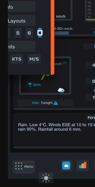

TORSTEN IOS 17.2
lorenz1982
Posts: 158
Post by lorenz1982 »
iPhone 15 Pro Max iOS 17.2 placed horizontally
MeteoBorgo: www.meteoborgo.it

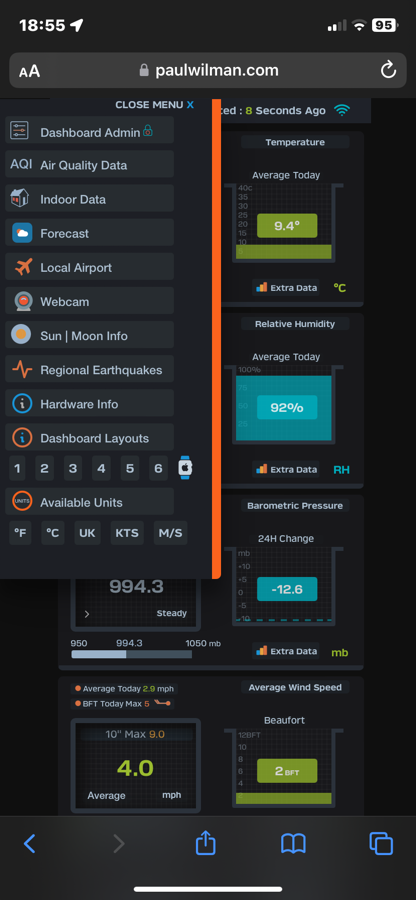

scratches head :-) will try and replicate but as shown below using paul wilman site on ios 17.2 iphone 14 ..cant be that difficult to resolve just a bit of css but I dont have iphone 15 but not sure how much difference there would be in screen resolution..anyway i will try my best :-)..brian
that said does this happen in only theme 1 ??
lorenz1982
Posts: 158

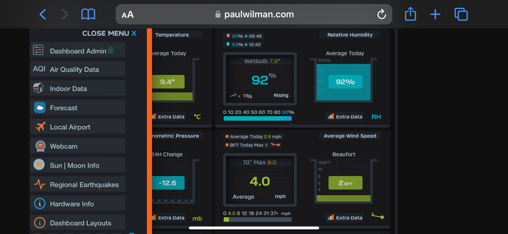

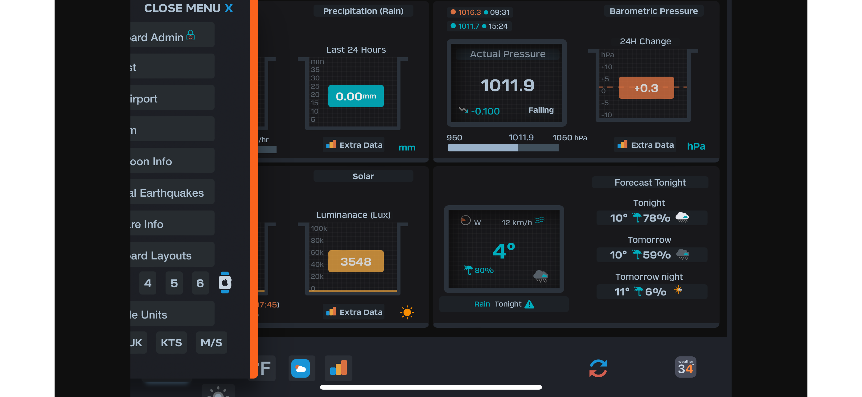

I also have the same problem on the paulwilman.com site.
On the theme 1-2-4-5.
Posts: 259
On the iPhone in portrait view this does not occur for me either, only in landscape format and on the iPad does the display problem occur.

I have an iphone 12 and have the same issue with the button dropping down on ios 17.2.
Paul
