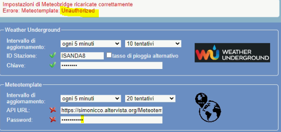

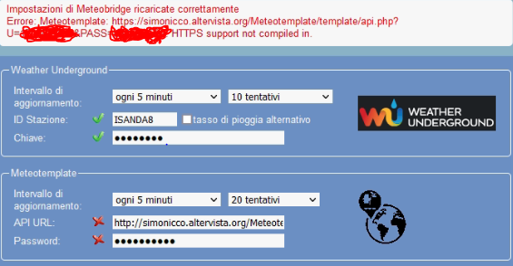

Hello everybody,
I write you this post because I have a problem with the connection between the meterobridge and meteotemplate, to update the data that populate this website: https://simonicco.altervista.org/Meteot ... esktop.php.
It worked until four days ago.

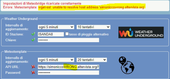

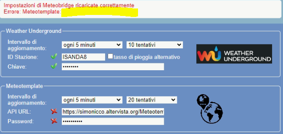

I don't understand why there isn't the reason of error in red: see highlighted in yellow in the picture "Empty" enclosed.
So I tried to put a wrong URL or a wrong password and the error reason appears in both the cases: see highlighted in yellow in the pictures "WrongURL" and "WrongPW" enclosed.
Can you help me to solve or give me information how can I understand the problem?
Thank you.
Matteo.

Re: Connection between meterobridge and meteotemplate
you may have an issue with your DNS server. That's the place where the domain portion of your URI gets translated into an IP address.
The message "unable to resolve ..." points in this direction
That server stands somewhere in the internet, with your internet provider or somewhere else.
It is not in your control.
Maybe the DNS info in Meteobridge got lost for some reason ...
Go to the Network tab and check the DNS entry - if nothing is there or only your router (gateway) IP address, change it to 208.67.220.220, restart Meteobridge and see what it gives. Also make sure that the IP address of your router is put into the Gateway field.
It's also possible the SSL certificate at your hosting server has expired.
Try http:// instead of https:// (anyhow your transferred weather data are no secret

MatteoCarnelos
- Fresh Boarder
- Posts: 19
- Joined: Tue Feb 20, 2024 3:29 pm
Thank you fo the reply.
But just to be clear, the "unable to resolve" message appears when I tried putting a wrong API URL.
While, when all the information (URL and password) are correct, there is no message ("empty" file in the previous post).
Do you think I should try with your indications anyway?

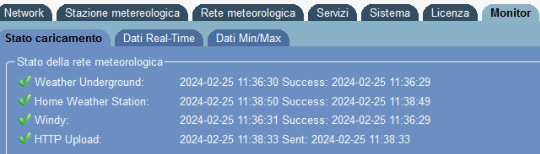

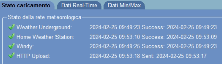

MatteoCarnelos
- Fresh Boarder
- Posts: 19

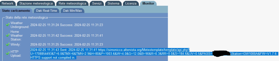

I tried, it doesn't work (see picture enclosed)1. try with http:// only and the DNS settings
following the b) option2. check at your Meteotemplate hosting site, if the API gets updated (I guess you have installed the API plugin/block in your Meteotemplate installation - if not, do so)
a) with the plugin
b) with a FTP client and check if the file meteotemplateLive.txt in the /template directory is updated and if it contains reasonable values
- with the stadard parameters the meteotemplateLive.txt was empty (last update is the day when all the problems started)
- with "posting the data via an Event" the meteotemplateLive.txt is empty yet (I put this adress:
https://simonicco.altervista.org/Meteot ... api.php?U=[epoch.1:]&T=[th0temp-lastval.1:]&TMX=[th0temp-max5:]&TMN=[th0temp-min5:]&H=[th0hum-lastval.1:]&P=[thb0seapress-lastval:1]&W=[wind0avgwind-lastval=kmh:1]&G=[wind0wind-lastval=kmh:1]&B=[wind0dir-lastval:1]&R=[rain0total-daysum:--]&RR=[rain0rate-lastval:1]&S=[sol0rad-lastval:2]&UV=[uv0index-lastval:1]&PASS=*******
I also checked in the Monitor tab if there is something strange but seams be all ok (see picture enclosed)
- Monitor.PNG (45.25 KiB) Viewed 6980 times
- HTTP.PNG (71.93 KiB) Viewed 6980 times

Your web-site does not allow http incoming traffic.MatteoCarnelos wrote: Sun Feb 25, 2024 10:57 amI tried, it doesn't work (see picture enclosed)1. try with http:// only and the DNS settings
It automatically switches that access to https.
The data seems to be arriving as . . .nicco.altervista.org/Meteotemplate/template/api.php?PASS=12345&t=1 results in an Unauthorized answer
Your Meteobridge does not support https outgoing traffic and stops communicating as the receiving server switches to https
At least according to the "not compiled-in" error message.
So use http:// only
But you have to set the http access for the Meteotemplate/template/api.php script in
- your .htaccess file in the root
- or in your cPanel

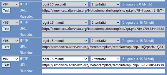

MatteoCarnelos
- Fresh Boarder
- Posts: 19

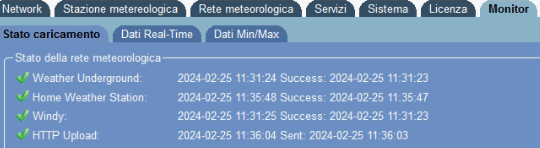

I tried four different event (see "Events" image enclosed)
- with "https" and standard parameters (see "Monitor tab - https" image enclosed)
- with "https" and real values (see "Monitor tab - https real values" image enclosed)
- with "http" and standard parameters (see "Monitor tab - http" image enclosed)
- with "http" and real values (see "Monitor tab - http real values" image enclosed)
Always same result: meteotemplateLive.txt not updated
Can you explain me how to do it? I'm using Filezilla to find .htaccess file in the rootBut you have to set the http access for the Meteotemplate/template/api.php script inyour .htaccess file in the root
- Monitor tab - https.PNG (55.88 KiB) Viewed 6962 times
- Monitor tab - https real values.PNG (56.48 KiB) Viewed 6962 times
- Monitor tab - http.PNG (85.89 KiB) Viewed 6962 times
- Monitor tab - http real values.PNG (90.58 KiB) Viewed 6962 times
- Events.PNG (96.09 KiB) Viewed 6962 times

The "not compiled in" message appears when the URL states "http" and Meteobridge makes use of the non-SSL supporting simple (busy box) version of wget to send data. Some web servers think they are the smartest guys in town and automatically redirect this http request to a more secure https request. Unfortunately, the non-SSL wget cannot handle this an throw an error. So in this case you have to use a https URL from the beginning.

I tried posting the data via an Event, see image named "DataViaEvent" attached.
In the URL of I wrote:
but the file meteotemplateLive.txt is always empty anda the data of creation of this file is the day when the issue started.
http://simonicco.altervista.org/Meteotemplate/template/api.php?U=1708854493&T=6.0&TMX=6&TMN=2.9&H=80&P=1003.6&W=4.0&G=12.0&B=90&R=0.3&RR=0.0&S=184.6&UV=0.5&PASS=XXXXXX&Station=GW1000A&FW=V1.7.6- Attachments
- DataViaEvent.PNG (22.99 KiB) Viewed 6926 times
