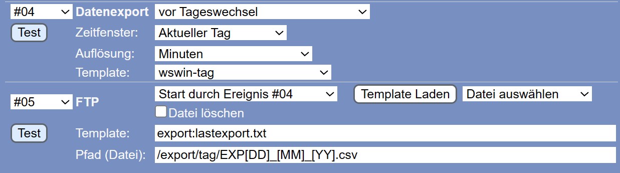

when you let the export create with "before each new month" periodicity and trigger the FTP upload event by this export generation event and make use of "lastexport" as source in the FTP upload event, the time stamps should be evaluated as you intend.

Thank you for the feedback. I've tried, but unfortunately, the data for the new day is still being written. This means that the data from February 27, 2024, is being written as February 28, 2024.
What am I doing wrong?
Re: Numerical Expressions
Can you please post the file names of the export files? As you do not delete them (which will btw run you into trouble in the long end) they still should be in the /data/export folder. timestamps in this names are expected to be evaluated for determining the data being taken.

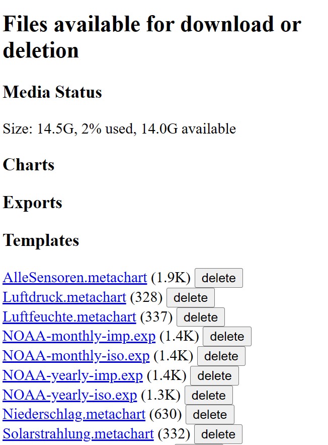

Here is the directory:
"I have now activated the deletion. However, I suspect that it will not solve my issue with the correct date."
I meant the name of the export files (not the ones given via upload on your server). They are named according the used template and have timestamps in their names. You have to look on the Meteobridge for those (can connect via SMB from your PC).

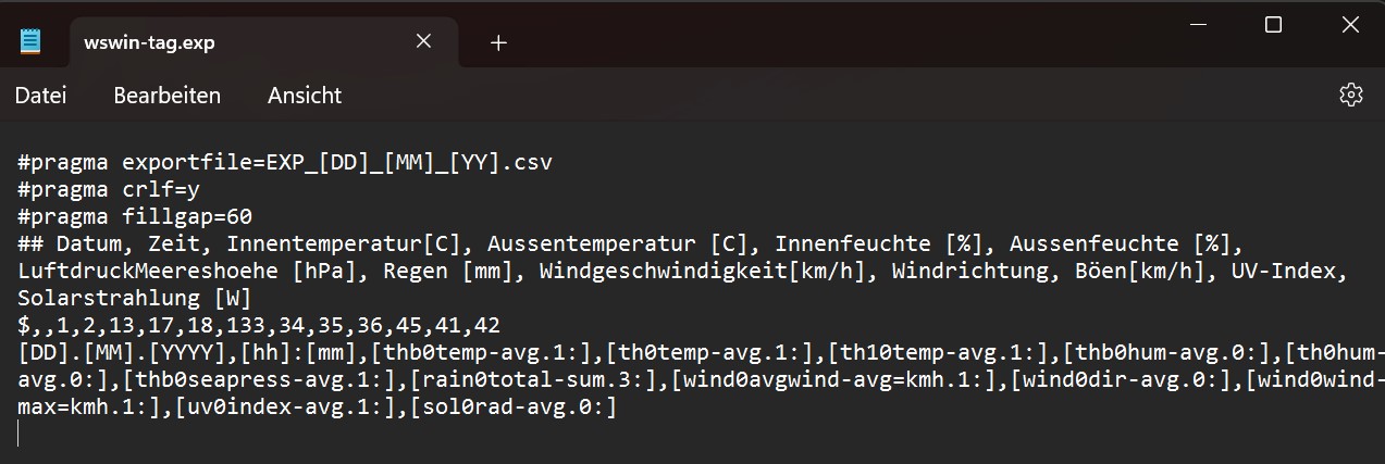

Do you mean that?
Nope. This is the wswin export definition in templates folder that is used to generate the export data. I asked for the file names of the generated exports which are in /data/export/ folder. There should be tons of it as you don't delete after upload.

Okay, that was the upper screenshot. I've only had it running for a few days. And I've also deleted it manually a few times. By now, the folder is empty. I've deleted everything.
Screenshot 2024-02-29 104424.jpg (129.18 KiB) Viewed 2106 times
As there is nothing in the exports folder, I cannot inspect anything.
I tried myself on my PRO2 and I found the root cause.
The used WSWIN export definition contains the following pragma to define the output filename.
#pragma exportfile=EXP[MM]_[YY].csv
Doing so the Meteobridge FTP upload cannot make use of the timestamp in the filename as it does no longer contain the expected information.
When you make a copy of your WSWIN template and remove the above mentioned pragma you can use this for export and ftp upload (please select delete option to avoid filling up your SD card).
