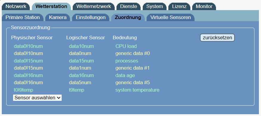

I have installed Meteobridge on my RPI4B. My Weatherstation is a HP1000SE PRO from Frogitt, but identical to Ecowitt HP2561.

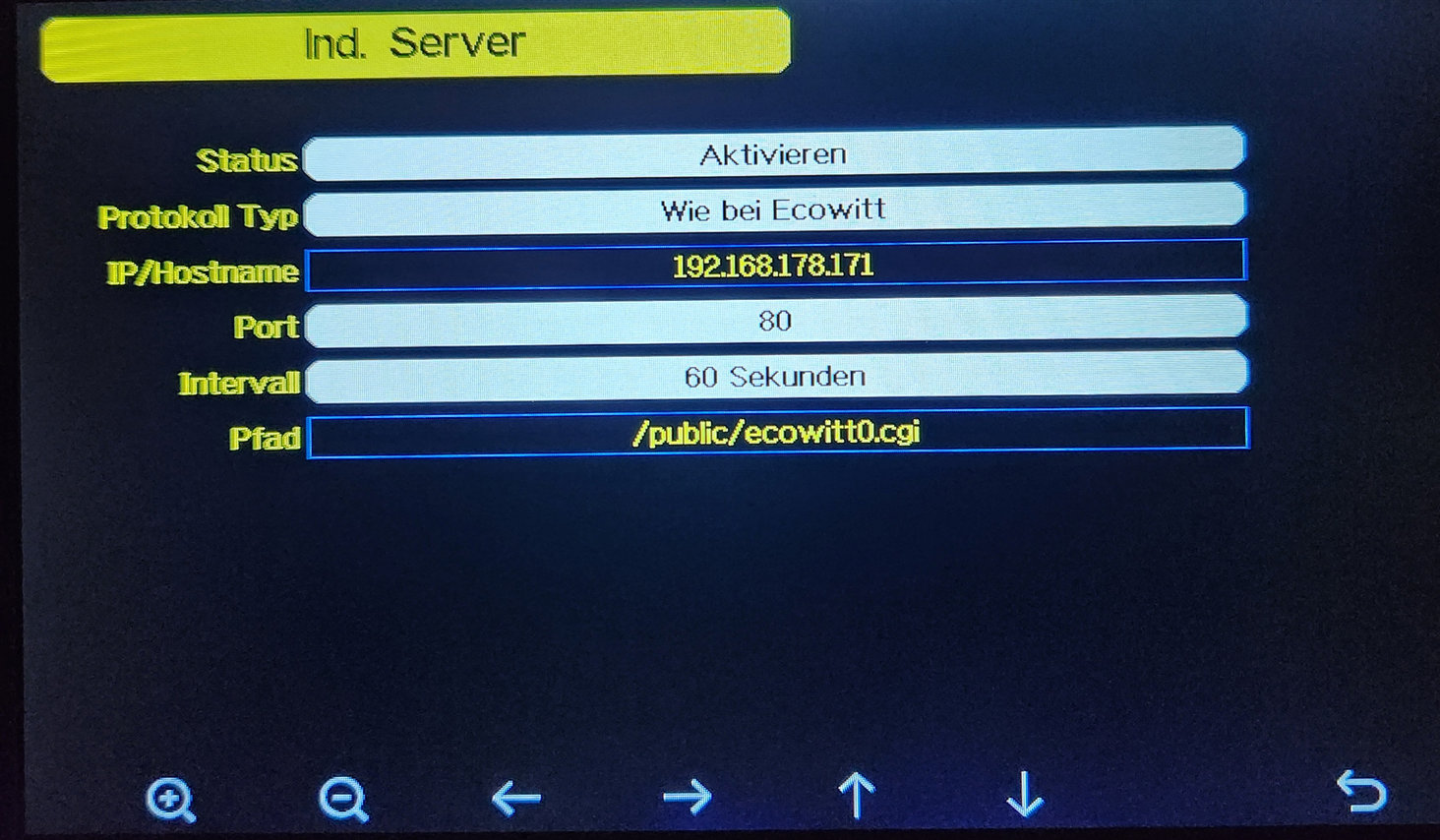

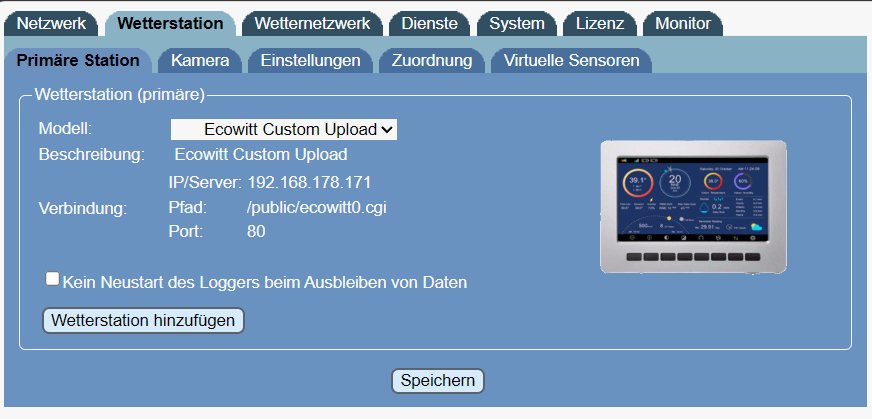

For "Weatherstation" I selected "Ecowitt custom Upload". I entered my IP and the CGI path according to the description on the display (see pictures).
But now, I do not now what I should do next, that my Values will be submitted.
I get some Values, but I do not now, where this from.

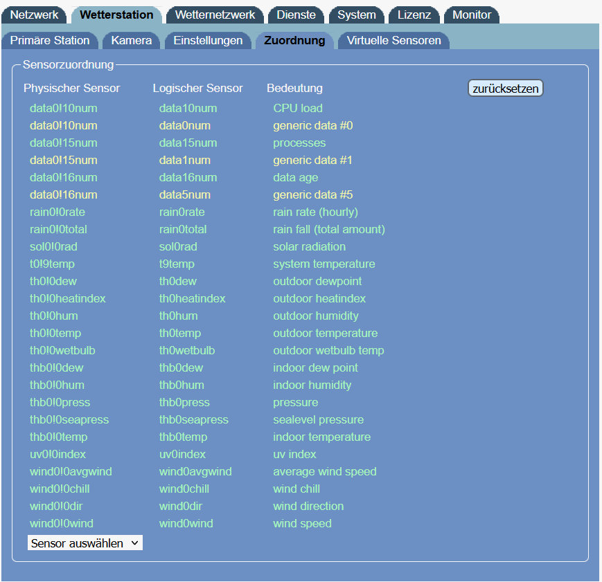

I must answer myself.
After I installed the WS VIEW App on my Mobile Phone and made an Update of the Firmware it worked!!!!!
I'm sooooo happy now!!!!!
All Sensor now available!!!!
