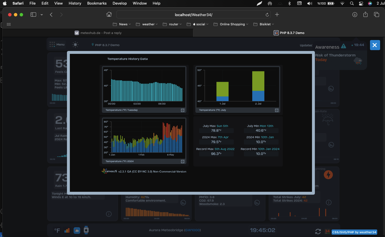

hello currently away till 2nd week of august been here down in south west turkey since 1st week of June. a quick peak at your site shows 2022 version did you revert back ?
if you can install latest version I can help you resolve quite easily . no others have reported the issue so possibly browser not using UTF-8 or something server related anyway not a big issue to resolve...
screenshot locally php 8.3.7 below of using F is this the screen you're referring too ? bran
