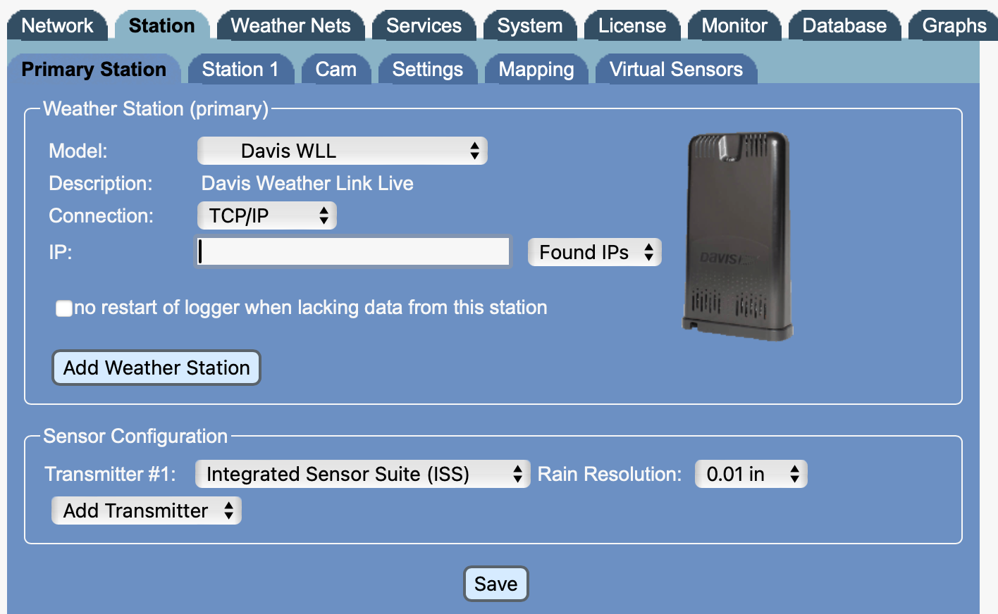

captgadget
Posts: 105
Joined: Mon Oct 31, 2016 11:05 pm
Re: Weatherlink 6313 setup
Post by captgadget »
I think is what you are referring to. If so this how you set it up.
Screenshot 2024-08-27 at 5.29.59 PM.png (238.1 KiB) Viewed 5718 times
captgadget
Posts: 105
Sorry, I just checked and it's a console for you but probably a similar setup.
Posts: 1492
captgadget wrote: Wed Aug 28, 2024 12:33 am Sorry, I just checked and it's a console for you but probably a similar setup.
Quite a different setup, WLL and the 6313 Console are at the user location whereas the MB is reading already uploaded data back from WeatherLink.com (Davis WL Cloud)
@Wessel I have setup a MBPro with Davis WL Cloud and associated API V2 Key & Secret but what I see is some data which is obviously coming back but not all and that may be because I have multiple stations (AirLink, WLIP, MBNano etc) under the one WeatherLink account but the API applies to the account and not an individual station? There is only one AirLink station in this account and the MBPro is receiving AQ data and that can only be from WL Cloud? Just don't have a single station in an account to test the theory.
