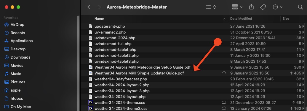

good morning
you should find two setup PDF files in the download this has all the necessary instructions to get you up and running .feel free to get in touch if you have any problems . for reference if you cant find the two PDF files they can be downloaded here https://www.mediafire.com/file/fpcf73z9 ... e.zip/file
