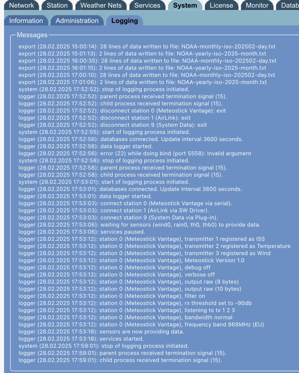

ImageAlready 2 times part of my events and weathernets dissapear without any manipulation. Also the database didn’t save per minute data anymore : this wasalso altered without any manipulation.
Are these configurations also in the back up and could I then restore them?
But more importantly what can be the reason of these sudden unwanted changes?
With my previous Meteobridge Nano I never experienced that kind of issues.
I added logging that might explain something?

Log does not indicate any data logging issues.
