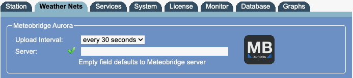

In cooperation with Brian we finally moved a slightly updated version of the Weather34 Aurora dashboard into the cloud, now named Meteobridge Aurora. It now just needs a few install clicks on the Meteobridge GUI and you have a full Dashboard implementation in the Internet ready to use without having your Meteobridge exposed to the Internet.
No need to book web space, no need to install files and to define data uploads, and also no need to install updates when new versions show up. Prerequisite of using Meteobriodge Aurora is to have just released Meteobridge version 6.2 running. Please read here for details: https://www.meteobridge.com/wiki/index. ... ersion_6.2

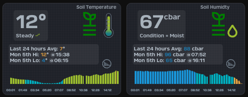

Setup screen has some additions like downloading and uploading data and two new charts for soil temperature.

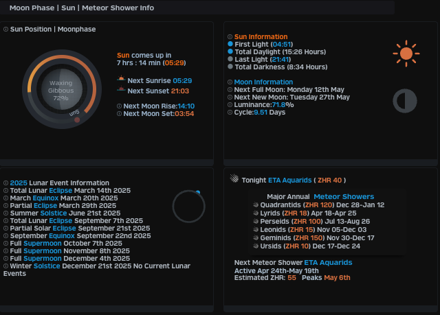

For some reason, I can't get anything to display in Sun/Moon info, which may also affect position 9 in the template (blank).
Guy
Sun/Moon looks fine to me, may be your location coordinates are missing? Which theme are you on? #9?

Trying 5. I do have coordinates in the setup. Whats odd is that tile remains blank no matter what I specify. If I inspect the page, I see this:
weather34-clock-tablet2.php:1
Failed to load resource: the server responded with a status of 500 (Internal Server Error)
index.php:336 Closing

Additional errors:
weather34-sun-moon-page.php:1
weather34-sun-moon-page.php:32 Uncaught TypeError: Cannot set properties of null (setting 'innerHTML')
Can you please send the Internet link to "info(at)meteobridge.com"? Things are working fine here.

Guy
Thanks for giving me access. Issue was, that your timezone "America/New York" was invalid, it needs to be "America/New_York". I changed code to make it more tolerant, resp repairing time zones with spaces in it. It now also shows a warning on setup page, when an invalid timezone is defined.
