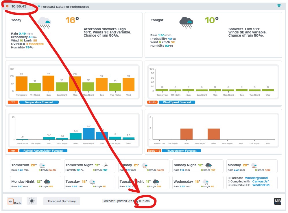

Maybe there is a time zone issue in the forecast update time?
- Immagine 2025-05-09 105718.jpg (147.56 KiB) Viewed 8714 times
